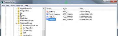

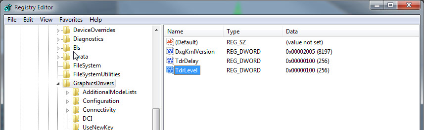

eklein wrote:Testing the "Displacement 700" file. I also can get the cuda 700 or Cinema 4D crash. The way to make it crash quickly for me is I have my Octane layout that has the IPR active, the Node editor showing the nodes and the material preview showing. Then do an octane render to the picture viewer. Then the picture viewer will fail or going back to the IPR will fail.
how much is your TdrLevel? Try 10-20 or more if it's required.

I've changed the TDR level and delay to match your screenshot and the scene still crashes.

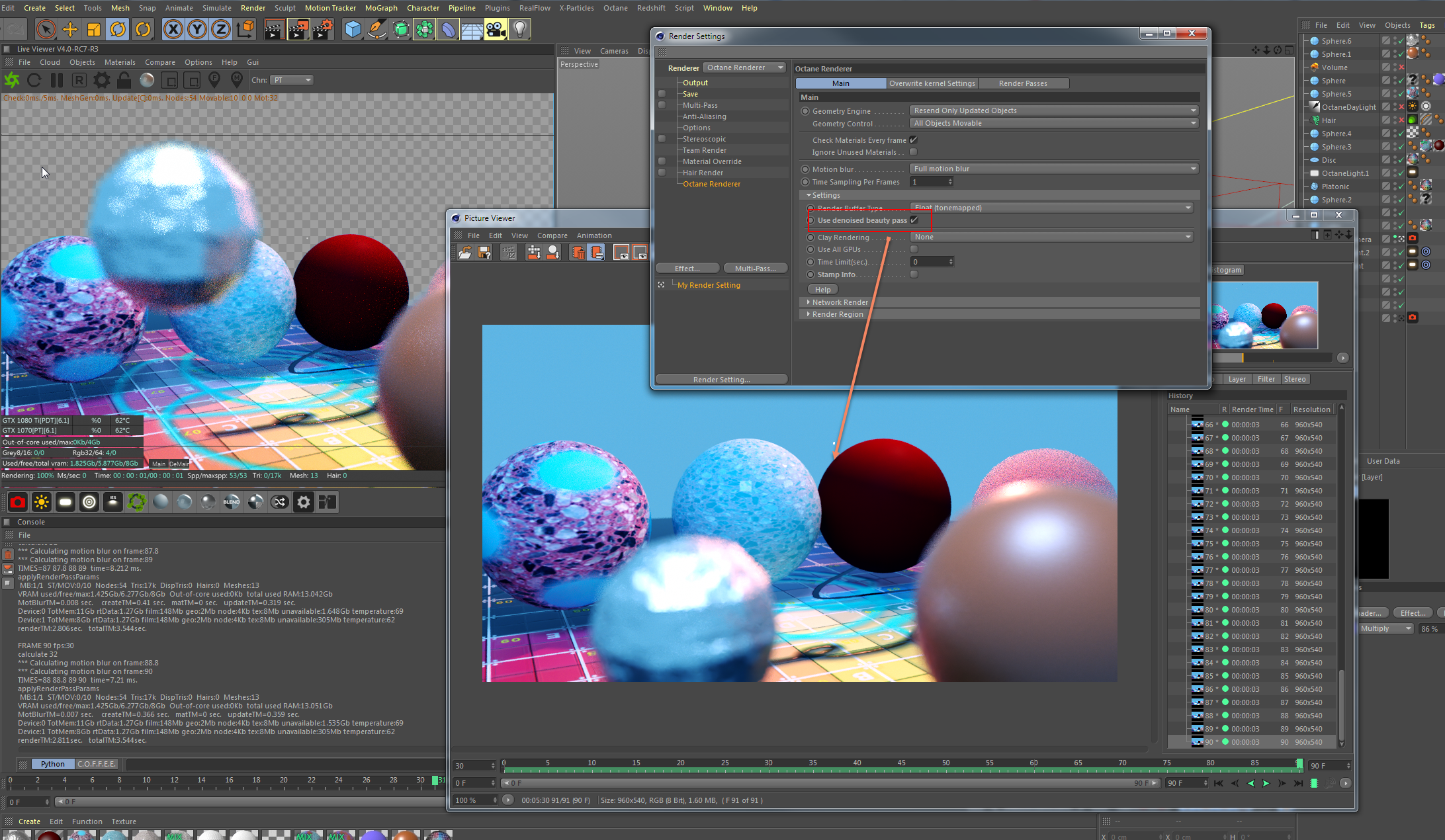

aoktar wrote:
FxDesign wrote:Hello Aoktar,
I'm in a situation where the render in the live viewer is different than the picture viewer.
Let me explain
With Xparticles, I'm emitting particles from a shader, then I'm meshing these particles with an Ovdbmesher.
I'm using the vertex color tag in the diffuse to have the vdb colored. In the LV no problem, but in the final render, the Ovbmesher has no color.
Here is a preview of my workflow.
Can you tell if I'm doing something wrong ?
Thank you
I think I need your scene to check.

I did change the TDR level and delay. It works better in the displacement scene but I have other scenes with complex materials that Octane fails quickly. We other plugins I don't have this issue.
