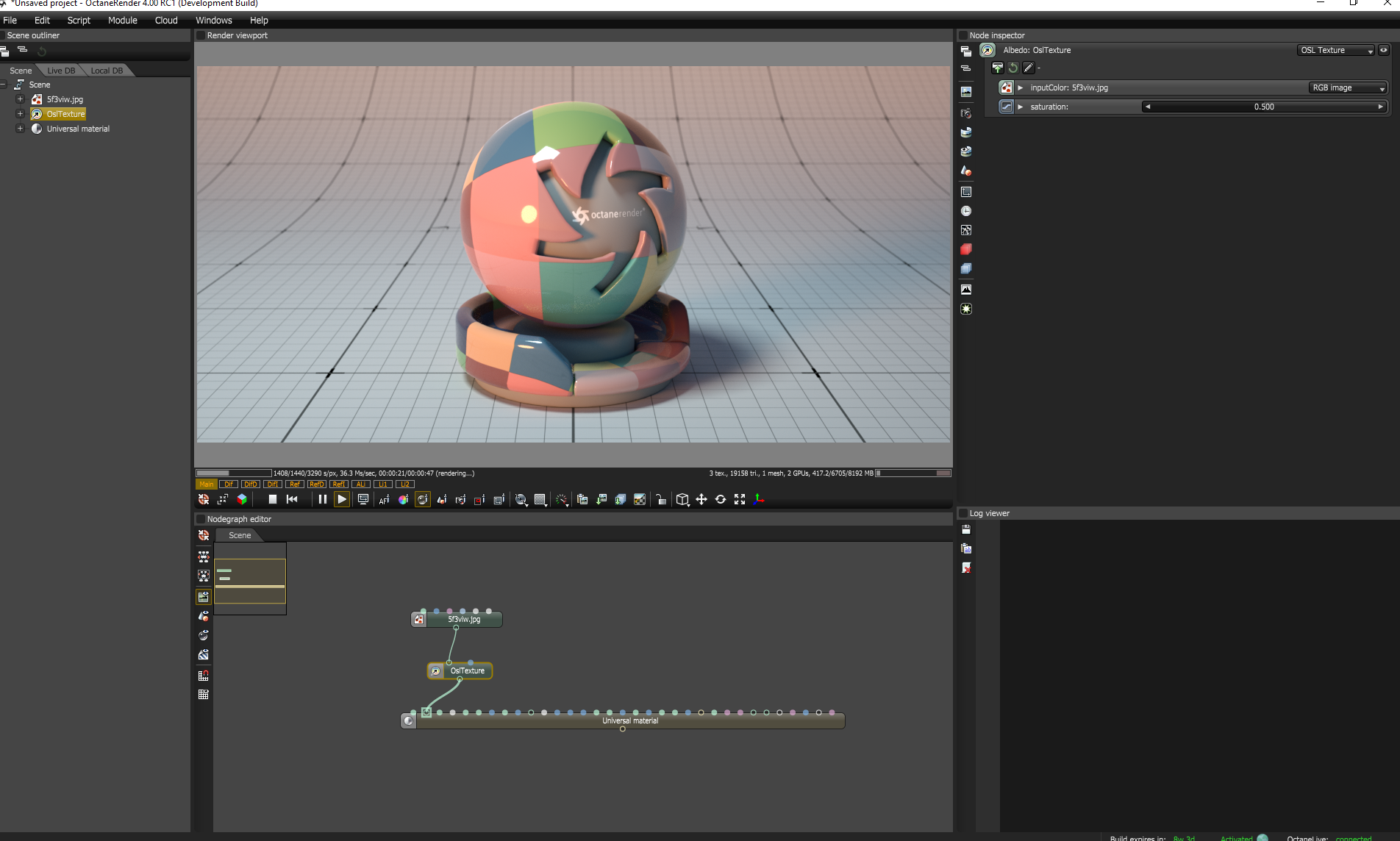

This is more of a general image operation you want to do, it's not strictly relevant to the universal material. You can actually achieve this via OSL texture, for example:
Code: Select all
shader OslTexture(
    color inputColor = 0,
    float saturation = 0 [[float min = 0.0, float max = 1.0]],
    output color c = 0)
    color hsl = transformc("rgb", "hsl", inputColor);
    hsl[1] = hsl[1] * saturation;
    c = transformc("hsl", "rgb", hsl);
saturation OSL texture

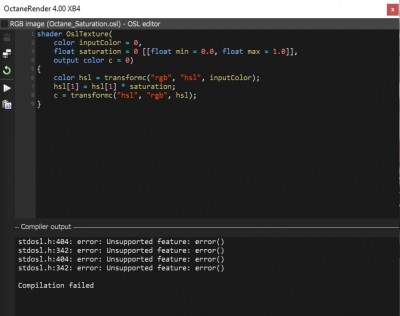

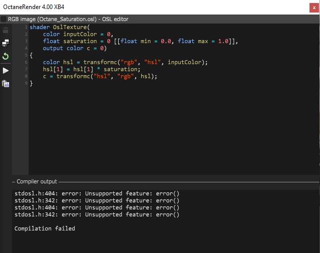

Hi, thank you. Do you know reason I might be experiencing this error:
Also, is it possible to still have Gamma and Power with Saturation, or can OSL only do Saturation without Gamma and Power?

Notiusweb wrote: Hi, thank you. Do you know reason I might be experiencing this error:
:oops:
THX!
My bad, it seems like it's a feature available post-XB4. The point of this is you can connect an image texture as an input to this osl texture node, so you don't actually lose gamma and power for your image texture.
I'd like to say you should use this OSL texture sparingly as it involves transforming between color space twice, so only use it when you absolutely need to change the saturation.
To use this texture node, please head over and download our latest V4 RC1: viewtopic.php?f=33&t=68491
