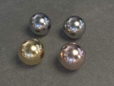

As an example, here is a scene rendered with some number of emitters:

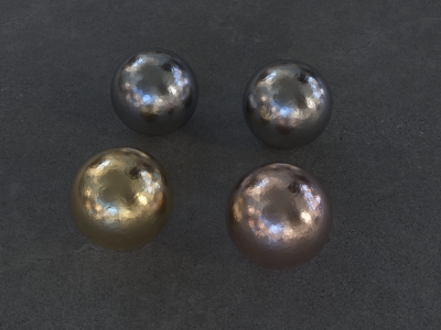

We then add another emitter:
But we would like to suppress the highlight of the emitter on the spheres, but keep the ground lighting and shadows, so we exclude that light on these objects' materials:
In the case that we want to suppress the highlight on only two, we can do that as well:

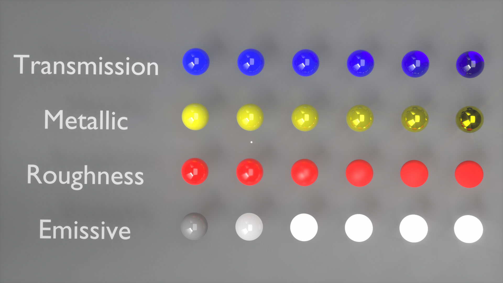

Universal material
Added transmission, dispersion, thin film interference, emission and medium to universal material. This means the universal material is now complete.

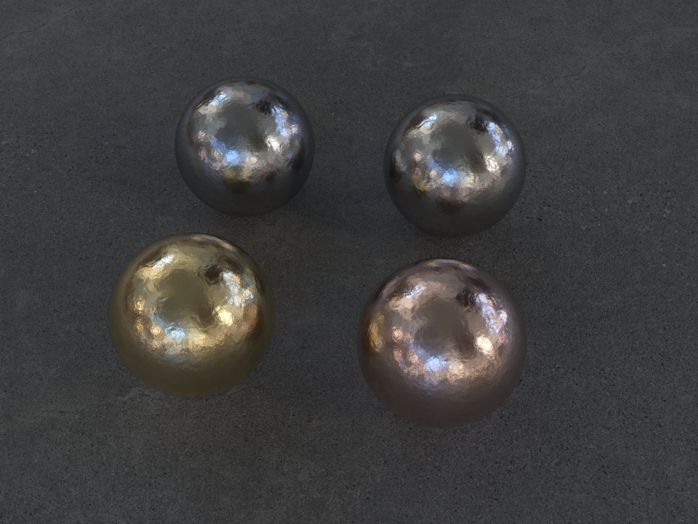

You can now have coatings, such as this:
Universal material now incorporates multiple BXDF lobes extended from the previous version of universal material, going from base layer to top layer in order:
  • Specular transmission
    Diffuse BRDF
    Specular reflection
    Coating
    Sheen
The universal material now has a transmission pin, which gives you control over the base layer of the material, simultaneously reducing the diffuse reflection weighting, thus letting more light transmit through the material. Working in conjunction with albedo color, the universal material can then render what we called the specular material in Octane as shown in the image.
Likewise, the metallic pin stays consistent with the previous iteration of universal material and allows you to specify conductor materials. The increasing level of metallic reduces the amount of light gets to the lower diffuse / transmission layers, so that when metallic is 1.0, there won't be any diffuse or transmission contribution.
The roughness parameter controls both layers of specular reflection and transmission, and hence it does the same for the metallic settings.
An emission pin is also added to the universal material to allow emission of light like the diffuse material.

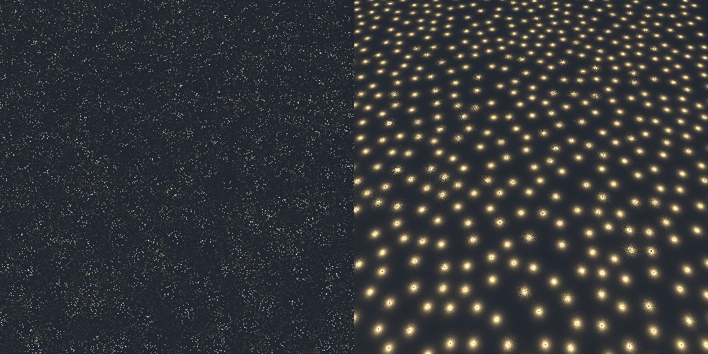

Improved AI Light
For many scenes, especially those with many directional lights, and fixed several other smaller issues.
A test scene below containing 1247 emitting quads - without AI Light on the left, and AI Light enabled on the right, for a total of 50 samples per pixel.

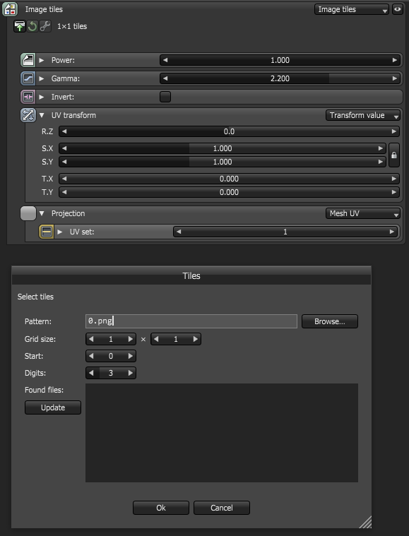

Added UDIM support
You can now create an Image Tiles texture node, which you can use to set up your tile grid.

Hi guys,
Can anyone tell me what I need to put in to "Image tiles pattern"?
I've tried to use maps exported from MARI, but octane node see only the same file name three/four/five times depending on which Grid size I choose
Thank you
