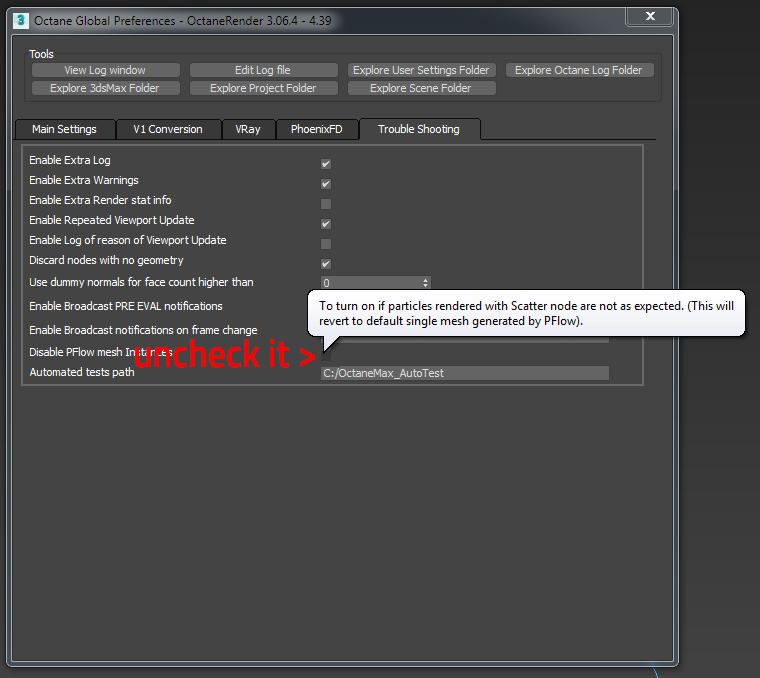

Hi Paridie
here is a follow up file for smoke fuel where fuel now is non renderable.
if you can simulate 10-20 frame and open viewport you will see smoke works and fuel does not
Thank you
Thank you

Hi coilbook,
5 time slower??
are you sure you have no issues around Hardware Configuration or paging system?
the workflow is very fast and does not have any issue unchecked pflow option (video attached).
Regards
Paride
5 time slower??
Regards
Paride
