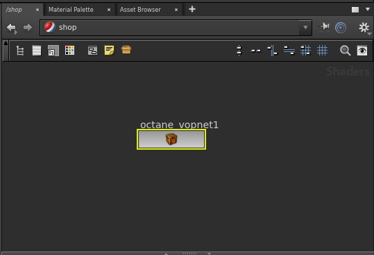

But I have little question - if I import material then it is
placed in shop. But I have shop networks inside obj - how
I can drop it there - copy/paste don´t work. Would be great
if import works on selected viewports (shopnets) - so whats
selected/viewed is get the material would be the easiest way.

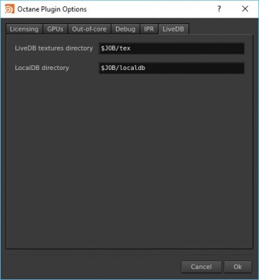

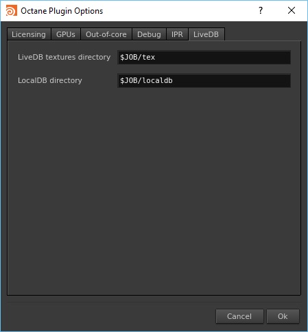

I think that the copy function inside the LiveDB window is not used in the plugins. To use the LocalDB you must configure the LocalDB path in the plugin options panel.

No matter what I do - the material is placed in shop - also if I drag the material
from LiveDB window into a shopnet/vopnet. And I tried to drag between 2 splitted
viewports - but if I drag from shop to obj/shopnet/vopnet - it drops into shop too.
And copy the node in shop and then paste into shopnet also not work.

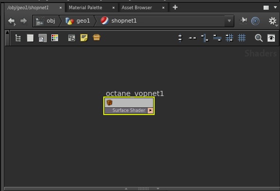

Sorry, the LiveDB materials inside Houdini are a node-by-node dump of all the material nodes from the Standalone format to raw Houdini VOP nodes. Currently they need some cleanup and manual configuration if you want to make them artist friendly.
I'll check tomorrow on OSX the copy/paste function, but in Windows works fine: select the octane vopnet node in /shop, ctrl+c, open the shopnet container inside the OBJ node, ctrl+v ... and works.

Now I have closed everything and started with fresh project - and suddenly it works - don´t know why ...
but hey its great.

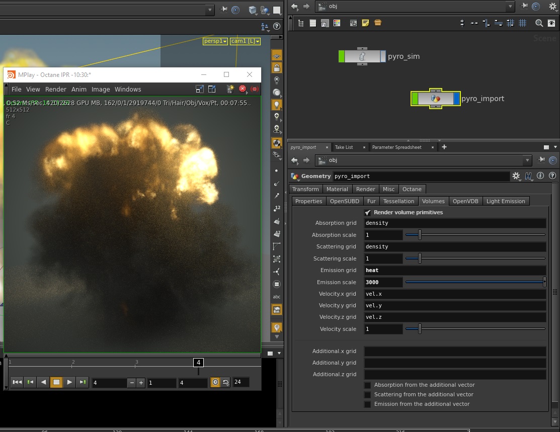

I have no idea how to shade pyroFX stuff - is it not possible in octane? mantra preview works well.
I tried a simple thing by create a box and add a flame from shelf. I get 2 geo + 1 dop nodes in fact
and if I apply a material at box node or pyro_import node there is nothing rendered - all black.
Can you help with screenshot for this setup please to get a rendered flame? - I think the solution
then can be adapted to all other things like smoke and so on - octane is quiet difficult to use in
many aspects and you have to plan a lot different then you would do with build in colors and so on.

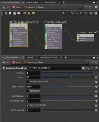

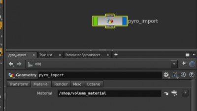

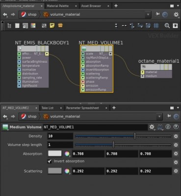

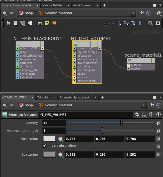

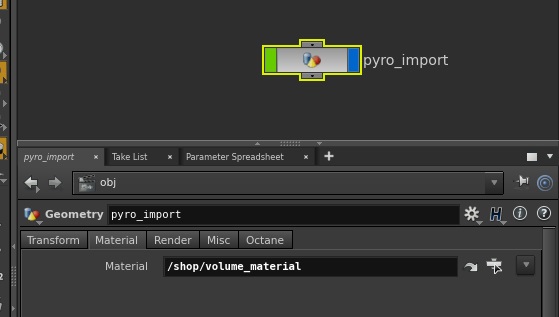

Attached you have a scene with a pyro volume setup for Octane. It is fairly easy render Houdini volume primitives with Octane. The basic steps are:
- Add the Octane spare parameters to the pyro import node, enable the volume rendering and set the grids names and parameters
- Build a volume medium material node, including an emission node if you are rendering a explosion like volue
- Set this material in the pyro import node material parameter
-Juanjo
