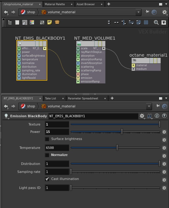

Attached you have a scene with a pyro volume setup for Octane. It is fairly easy render Houdini volume primitives with Octane. The basic steps are:
- Add the Octane spare parameters to the pyro import node, enable the volume rendering and set the grids names and parameters
- Build a volume medium material node, including an emission node if you are rendering a explosion like volue
- Set this material in the pyro import node material parameter
-Juanjo

Thanks a lot - your support is outstanding ...
