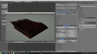

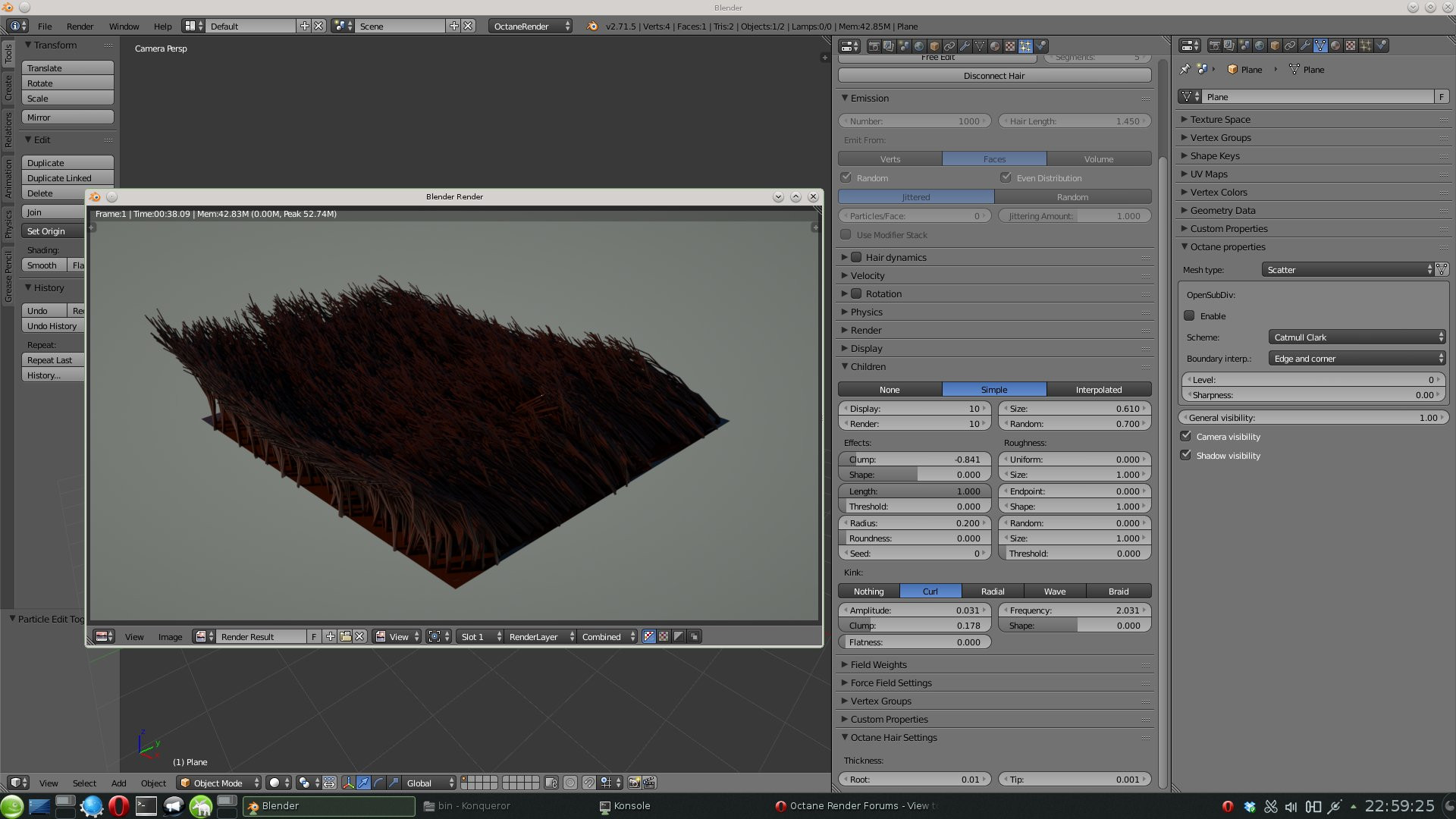

Wrong. It can be rendered if you set the mesh type properly. Trying to use "global" mesh for heavyly scattered geometry is wrong way.;)
OK thanks it works. I was wrong, too excited, and too speed ^^. Nice to sse that we can assign a different material to parent object and hair and fur! How does it work? Does it render strands, or geometry type ??
Hmm. Could you please elaborate on how you got hair to work? I've tried everything I can think of. So how can I not use "global" mesh scatter?

Hi, hair should work out of the box, Global or Scatter is more a setting to influence memory .
Cheers, mib

mib2berlin wrote:Hi, hair should work out of the box, Global or Scatter is more a setting to influence memory .
Cheers, mib
Awesome. Thanks mib.
