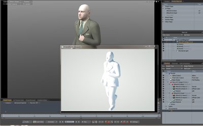

1st, just importing them as-is they render with the default base color

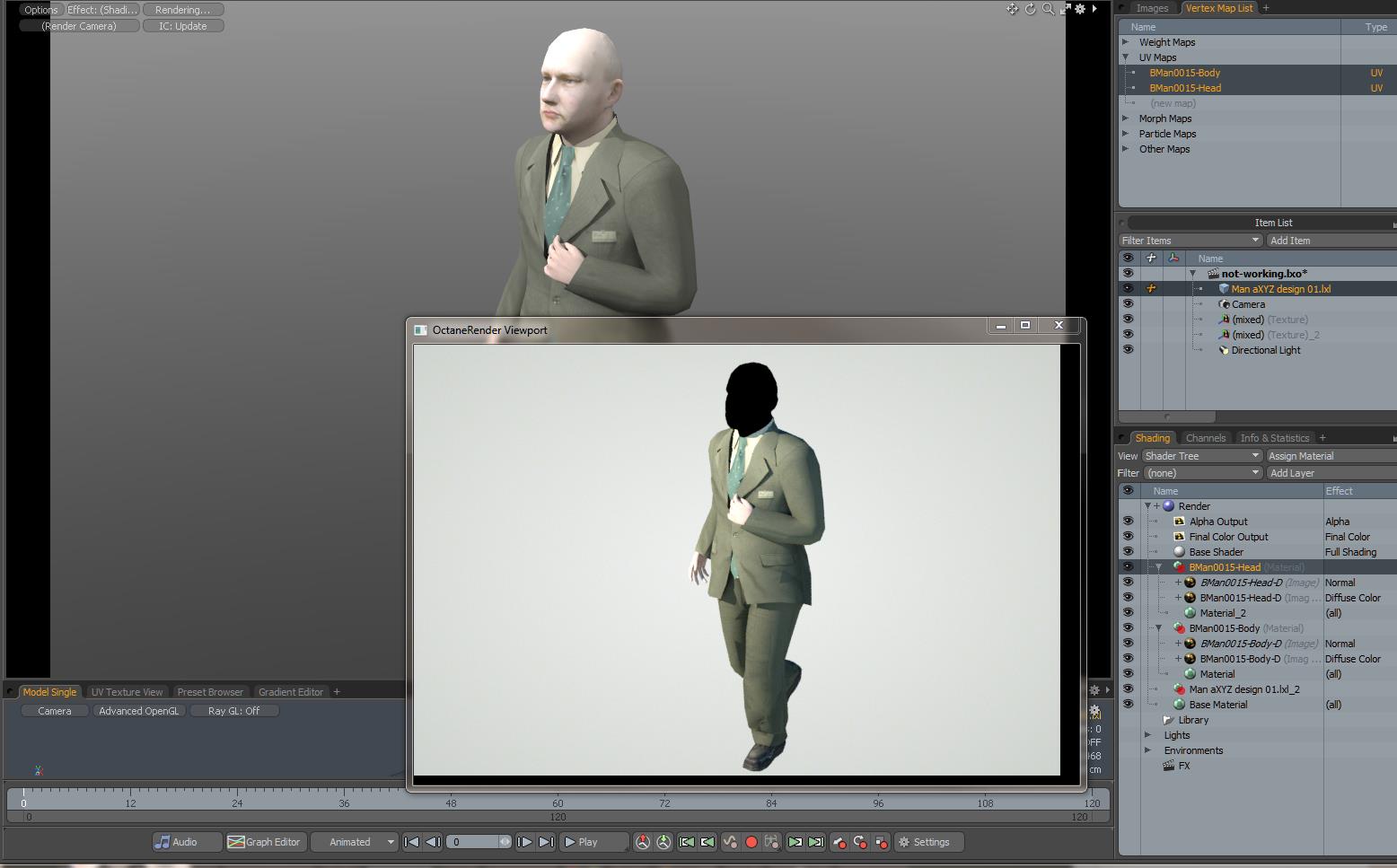

2nd, after pulling the individual shaders up to the top level out of the imported container, the body shaders work but the heads did not... head just rendered black. After spending a bunch of time trying to figure out what the problem was, I finally stumbled across the extra UV maps... body and head are both in the same mesh, and had 2 UV map sets. The reason the body worked ok, but the head does not is because the body UV map was first on the list. I selected the head cut/paste out to a new mesh and deleted the body UV map. did the complement to the body, and renamed them both to the same UV set name, and merged the meshes back together. Now everything renders fine. - but

step 1 import man:
- Snapshot of not working
step 2 pull shaders out of container
- Snapshot almost working

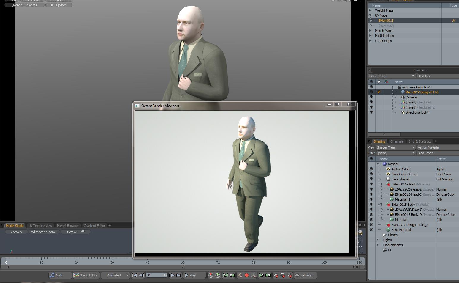

step 3 merge uv sets to a single uv set.
- Snapshot finally works
