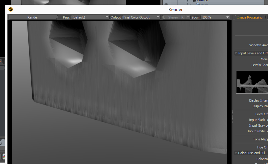

These are Vertex normals generated by Modo's own Advanced CAD loader when importing a .STP file. And it renders fine in both modo and another 3rd party renderer.
Here is a link to a jpg with octane vs modo's own render. in both cases the left has vertex normals and the right one have them deleted.
https://www.dropbox.com/s/fmioms3gu0ype ... ormals.jpg
here is a link to the .lxo
https://www.dropbox.com/s/bbn3wulci9o9t ... ormals.rar
/M
face_off
Posts: 15822
Location: Adelaide, Australia
Thank you for posting this info. If I render the block on the left in Modo - it doesn't look right to me. I think the normals are wrong, so are being into Octane incorrectly.
Pls see below.
Paul

MagnusL3D wrote: These are Vertex normals generated by Modo's own Advanced CAD loader when importing a .STP file. And it renders fine in both modo and another 3rd party renderer.
/M
Problem, I think, is that the material shader has edge rounding on @ 2mm.
I don't believe that is a supported feature in Octane, since it's still on the list of requested features.
If you turn off edge rounding (set it to 0mm) the modo render and octane render match.
I was able to achieve this effect by baking the normals including those from the round-edge and creating an override. However, I wasn't able to do this with your files, because the UVs aren't 0-1... so baking a normal map doesn't really work with that AFAIK.

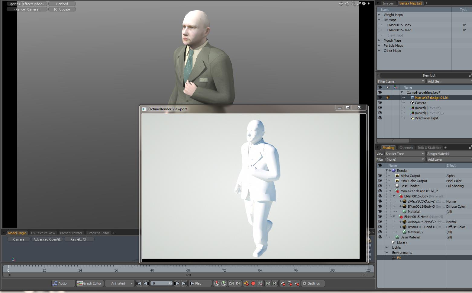

So, I guess multiple UV Maps aren't supported? I beat my head against a wall for half a day trying to figure out why the man and woman presets wouldn't render in octane.
1st, just importing them as-is they render with the default base color
2nd, after pulling the individual shaders up to the top level out of the imported container, the body shaders work but the heads did not... head just rendered black. After spending a bunch of time trying to figure out what the problem was, I finally stumbled across the extra UV maps... body and head are both in the same mesh, and had 2 UV map sets. The reason the body worked ok, but the head does not is because the body UV map was first on the list. I selected the head cut/paste out to a new mesh and deleted the body UV map. did the complement to the body, and renamed them both to the same UV set name, and merged the meshes back together. Now everything renders fine. - but
Question:
1) will octane and/or the plugin be supporting multiple uv sets?
2) any idea why the shaders in the container nodes don't render unless they are pulled out?
attached is the working and not-working files. (non-working file is simply new file and placed man asset into the scene)
multi-uv-sets.zip
Contains both working and not working lxo files
(551.48 KiB) Downloaded 318 times
step 1 import man:
Snapshot of not working
step 2 pull shaders out of container
Snapshot almost working
step 3 merge uv sets to a single uv set.
Snapshot finally works
Firstly - thank you for posting detailed info on your issue - helps a lot.
Secondly, part of the problem you are experiencing is due to the head and body material being grouped within another group (as you point out in your post). The plugin needs to handle this situation, and I will have a fix for this in the next few hours.
Thirdly, Octane does not currently support multiple UV maps for a single mesh, so that is a limitation the plugin will have. Having said that, I will do what I can to minimize the impact of this limitation.
Let me get the fix described above done first, then I will look into the scene you posted in more detail.
