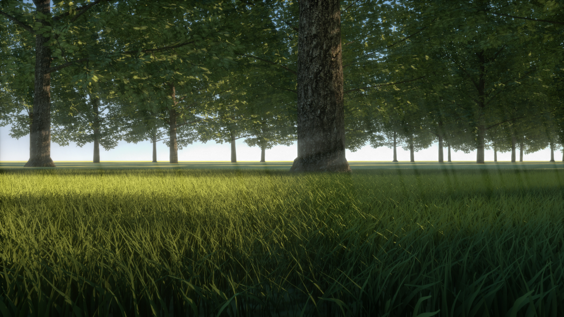

Hairs: 600'000, 12 pts.
Trees: 100 clones, 41'300 polys each.
PT, 16, 2048 samples in 1 hour on a GTX 590 - 3Gb total vram.
I have to say that live view doesn't render hair... I can render hair only by hitting the render button. Is this a bug?

nice try:) hair is done with instance? I'm not sure about live view. But normally can render instances, there is no different between Render View.renderfarmsrl wrote:Cool!
Need to check

Hair direct render
Next I will try the Render Batch list...
