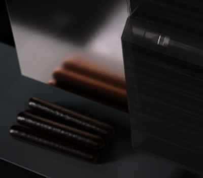

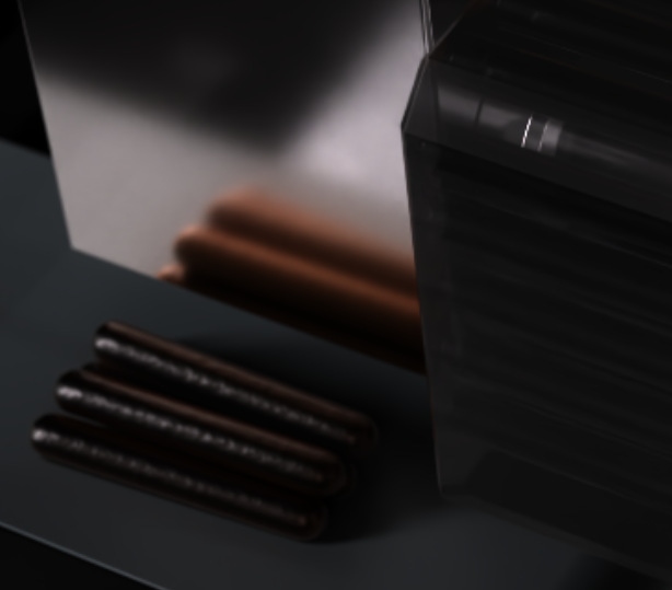

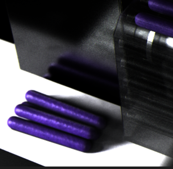

Hi Chris,
thank you for taking the time for this.
The issue is:
when I start the render over night. I render 100 Frames.
Then I stop it for the day. In the evening I set the frames to render from 101 to 200.
And these new frames are broken, even though nothing change in the project.
This never was an issue, until I used the Open image denoiser on Reflection and Refraction passes in the AOVs.
So when I import the image sequence in After effects. The frst 100 frames look good. But the new ones are broken. Not only the AOVs but also the normal beauty pass.
here is the result in AE.
Image A is from the first render
Image B is from the second.
Same AOV pass displayed.
