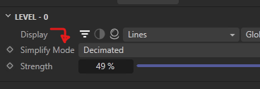

It would be great if Octane treat simplify mode in LOD object the same way as it treat display mode so it will be not "visible" to Octane renderer but only for regular C4D viewport :

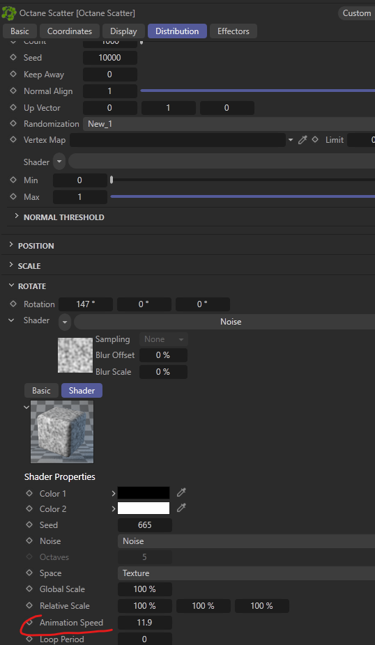

C4D noise animation speed parameter completely doesn't work inside Scatter Effectors. Animation in Scatter effectors works only for C4D Random effector but not for Shader effector.
It doesn't work for regular parameters too :
Strange that all noises works fine only if random effector is inside Octane Scatter - even if it do nothing. Please try disable random effector and all animated parameters from other noises will stop animation :
oct_scatter_effectors.zip
(37.47 KiB) Downloaded 242 times
Live Viewer stop display object animation from animated deformers if C4D viewport is used - move, rotate - EDIT : it works if playback in all views is turned on in C4D preferences.

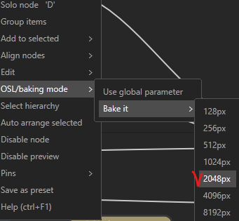

Substance Materials in Octane :
Diffusion channel of C4D materials is not included in Octane C4D shader baking. It is used for occlusion in substance assets.
C4D shader baking render size do nothing for C4D baked materials and substances it works totally randomly after every LV restarts.
Please see - it is completely broken :
c4d_res_baking.zip
(456.67 KiB) Downloaded 181 times
Converted substance material to Octane material doesn't update in realtime when we change substance parameters - it needs to restart LiveViewer every time Substance parameter is changed. Please try Old Heavy Victorian Handmade from Asset Browser.
When we set custom OSL baking resolution there is no any visible sign which one is chosen :
