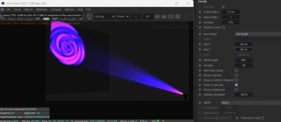

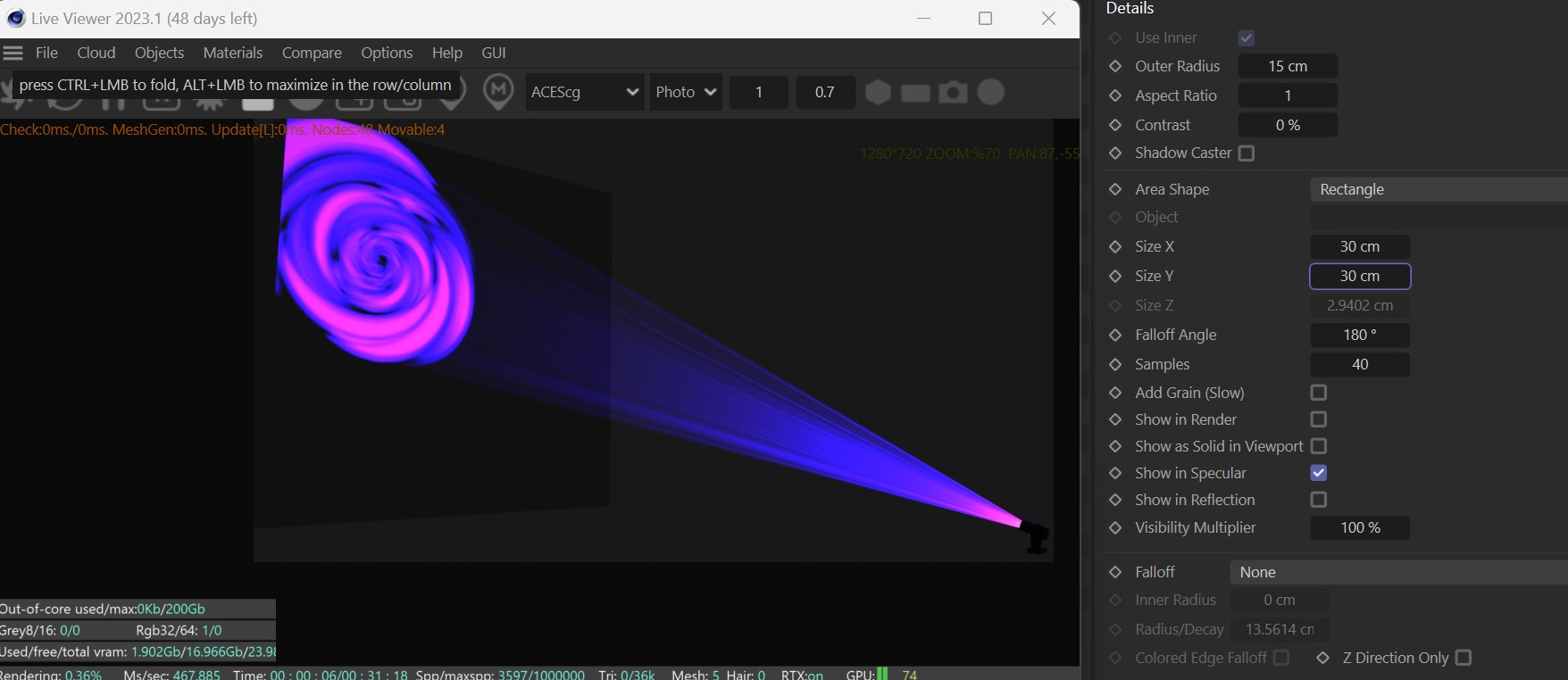

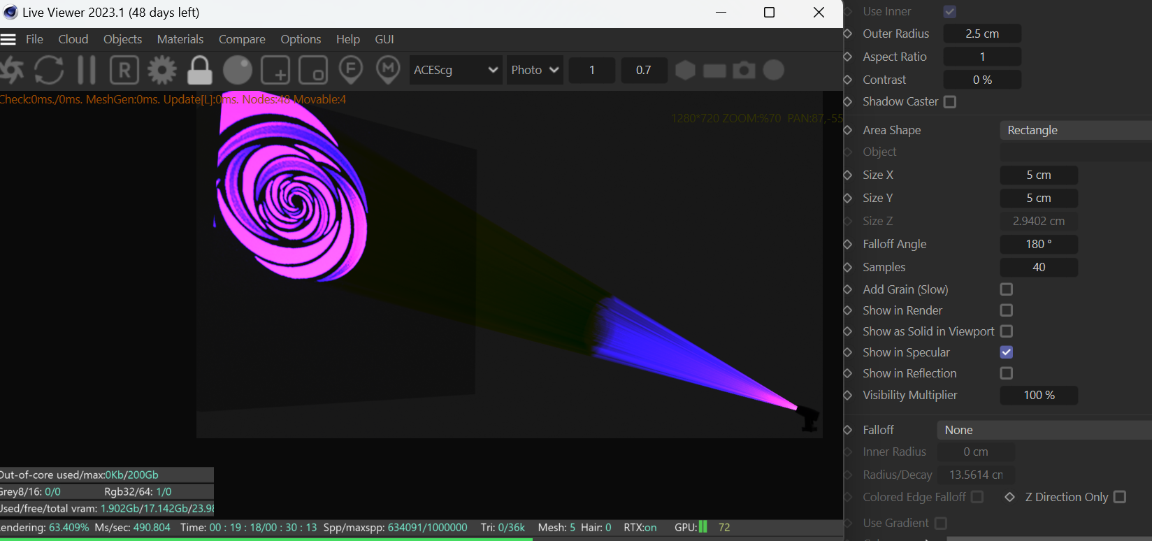

When the size of the Area Shape gets smaller (5cm x.y.) the Gobo will get more focused, but the light beams will stop mid way.
If the size of the Area Shape gets larger (30cm x.y.) the Gobo will be out of focus, but the beams will shoot further.
It would be nice if the beams would still persist even with a very small emitter.

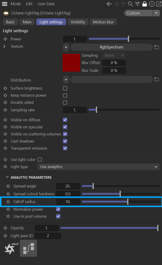

Use the Falloff Radius in the Octane Light Tag > Light Settings > Analytic Parameters to control the length of the Analytic Light Beam, as shown in the image.

krisclemson
Posts: 8
Joined: Sun Mar 24, 2019 10:57 pm
Maxed out Falloff radius
