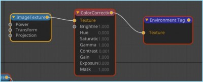

If color correction node is connected to OctaneSky texture there is no way to rotate it by using Octane Sky tag or even OctaneSky object.

Try plugging a Transform node into the Image Texture node.

SSmolak wrote:If color correction node is connected to OctaneSky texture there is no way to rotate it by using Octane Sky tag or even OctaneSky object.
When color correction is connected, the image rotation must be controlled via "TRANFORM" node.
Some of your posts are actually known and described issues or limitations. This feature is up to plugin and just works if you put ImageTexture without insert anything between UI and node
Yes it works that way but losing sync with OctaneDayLight after that ;)

SSmolak wrote:
With Color Correction, the Daylight rotation becomes useless...

Kalua wrote: With Color Correction, the Daylight rotation becomes useless...
Thanks to Composite AOV color correction and mixing with Beauty it can be easily done without losing Octane Sky & Daylight sync.

Kalua wrote:
SSmolak wrote: Yes it works that way but losing sync with OctaneDayLight after that ;)
Sorry what kind of synchronization are you talking about that I'm not aware of?

aoktar wrote:
If we have HDR sun rotated to position of OctaneDayLight sun grouping them together makes that they stay with sync while rotating OctaneSky- it is described in manual too. But adding node between HDR and OctaneSky input cause that rotating not include HDR image rotating as was described before.
