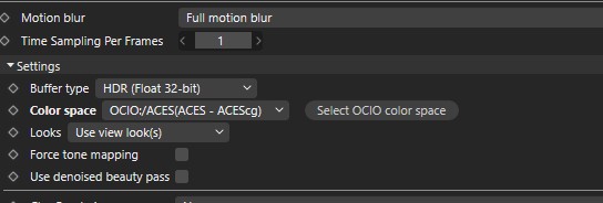

SSmolak wrote:From PV. If color space is set to main ACES it works fine - full 32bit output but if color space is chosen from OCIO list it saving as 8bit.
Images are after 32bit exposure correction in external software.
From SSmolak's second shot in this post from the previous page, the OCIO is Rec 709. That may be the problem. Rec 709 is usually defined as an 8bit color space with values of 16-235. I use the OCIO setting in the picture and it matches the ACESCg setting as well. Notice my OCIO/ACES selection. Anyhow, this is what works for me.

BCres wrote:From SSmolak's second shot in this post from the previous page, the OCIO is Rec 709. That may be the problem. Rec 709 is usually defined as an 8bit color space with values of 16-235. I use the OCIO setting in the picture and it matches the ACESCg setting as well. Notice my OCIO/ACES selection. Anyhow, this is what works for me.
But that problem is with EVERY OCIO profile other than standard ACES even Filmic one from https://sobotka.github.io/filmic-blender. They all give 8bit output just like Octane while using Camera Image corrections.

I apologize SSmolak, I see the problem you're having is with ACES configurations other than the ACES official (which is what I use.) My mistake. It was your example using REC709 that threw me.
