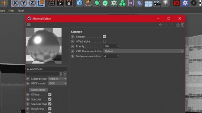

Thanks! Good to know.
I think is C4D which is setting 100 as default - or perhaps pre-2020 shaders are set to 100 when reloaded.
