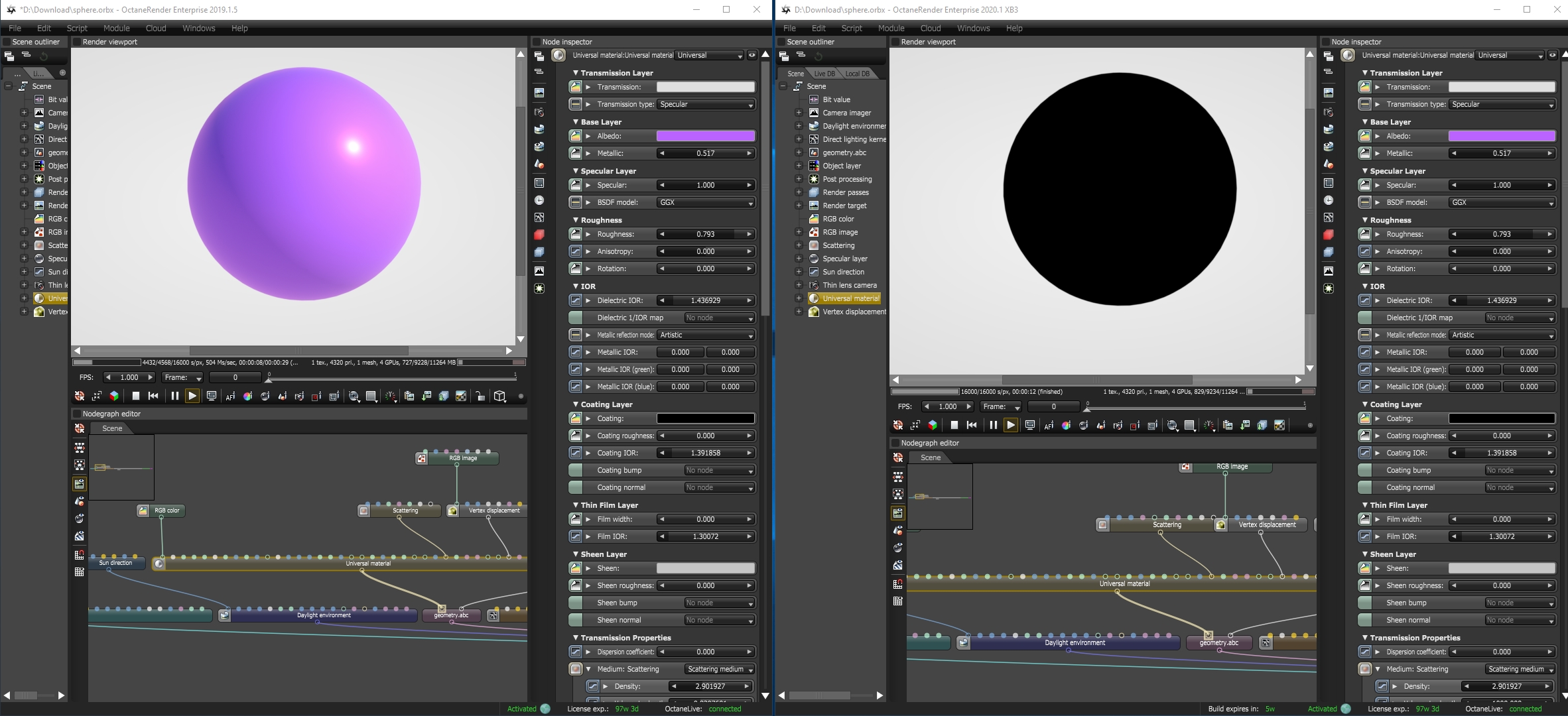

Please OTOY/DEVs look at this very simple ORBX file. in 2019.1.5 it render correctly while in 2020.XB3 it renders BLACK (Universal material)
Please fix it to be correct like in 2019.1.5?
