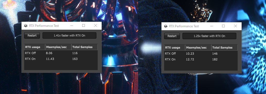

divasoft wrote:
mojave wrote:
roinigo wrote:...The RTX Performance Test doesn't work here (with RTX 2080 Ti) :
Looks like RTX is not enabled, please make sure you have a driver installed of at least the versions mentioned at the beginning of the release post.
No, RTX now is really useless thing. I tested it in many scenes and yes i checked on RTX in device settings.
Thanks for sharing your scenes with us @divasoft.
After some tweaking on our side we could get this speedup out of the box.
The reason for the behavior you could see was that due to that geometry using the fast rounded edges shader would not be processed by RTX.
These changes mean all scenes using fast rounded edges shader will be experience a larger performance improvement with RTX from the next release.
