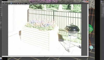

I got news about my overbright images issue. maybe you remember.
It seems to appear if HDRI Gamma is greater 1 and Exposure in Imager also with an higher value.
For example I had to change HDRI Gamma from 1.1 to 1.0 and Imager Exposure from 4 to 0.3 to get the same look than in Octane 3. I hope it helps a bit to nail down the source?

Hi mbetke,mbetke wrote:I did. Will observe and report back.
could you check if opening that scene with V3 and V4 response curve or order was changed?
Regards
Paride

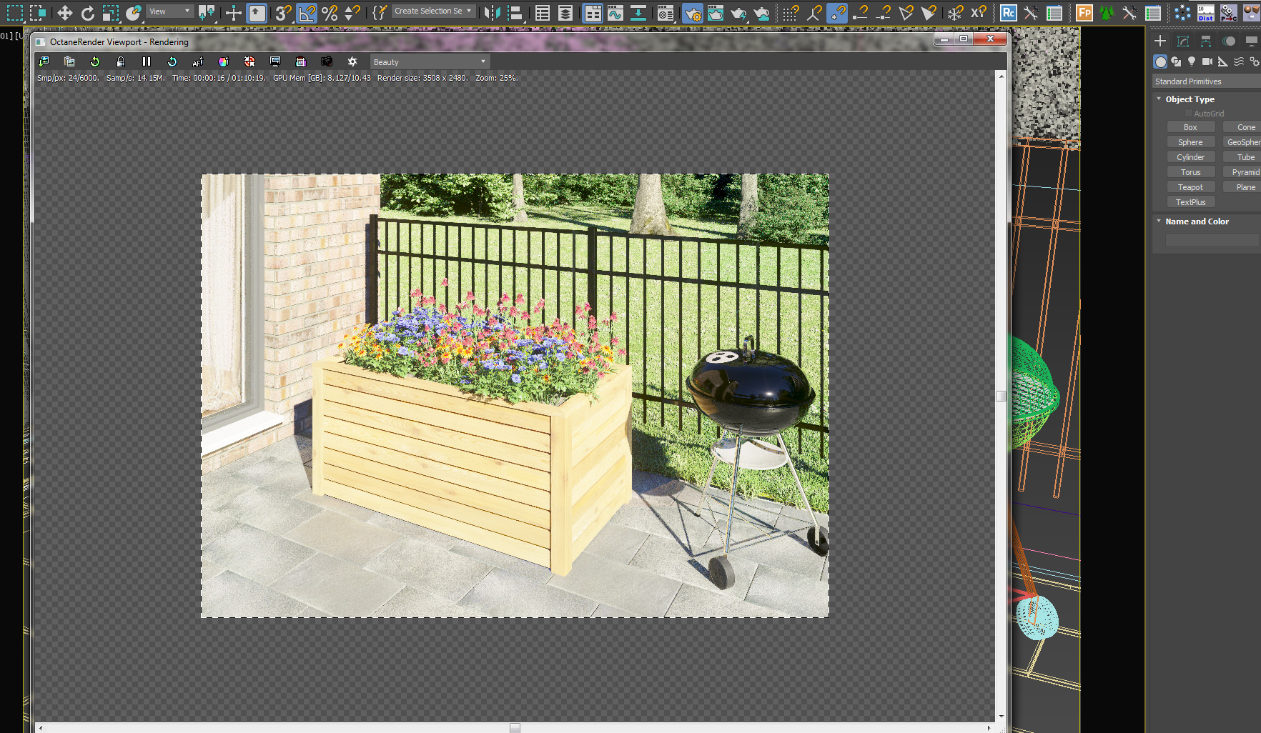

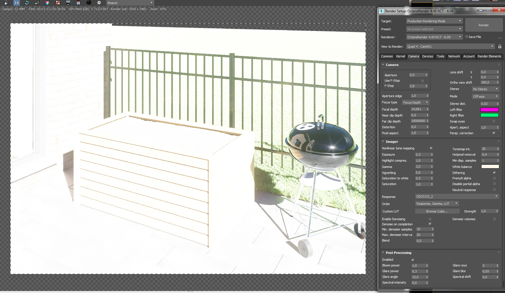

I got a very nice example this morning while re-using a 3.07 scene.Hi mbetke,
Regards
Paride
Win 7 / i7 5
With 3.07 all is fine. A bit bright but that was my setting. HDR Gamme is 1.3, You can see orange tones of wood and green gras looking good.
Then I installed latest 3.08. Response curve in default "Response/Gamma/LUT" order. Image totally blown out. After that I set HDR Gamma down to 1.0. Brightness looking normal, but wood and gras looking a bit blown out.
On version 4 (latest), same look and behavior like in 3.08. Response curve in default "Response/Gamma/LUT" order and not changed. Same Gamma behavior.
Must really be a combination of envionment texture, and imager. Because like I wrote before, as soon as i rebuilt the same environment textue HDR setup from scratch all looks like it should. Just copy/pasting doesn't work. I need to rebuilt it.
