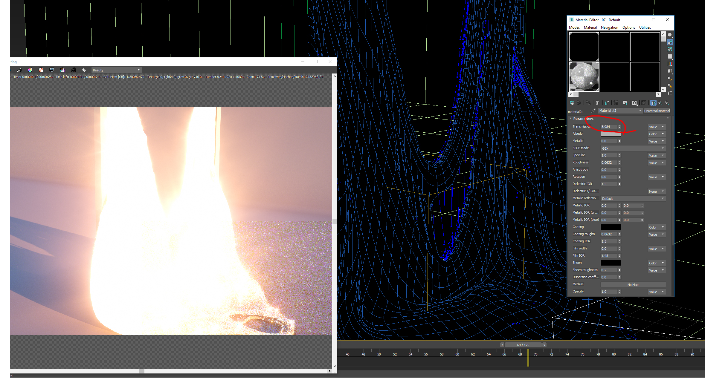

Hi Why when I try to increase transmission instead of glass effect it starts glowing Thanks
my goal is red hot melted glass. ANd i thought in the uber material you can have clear and light emission at the same time
