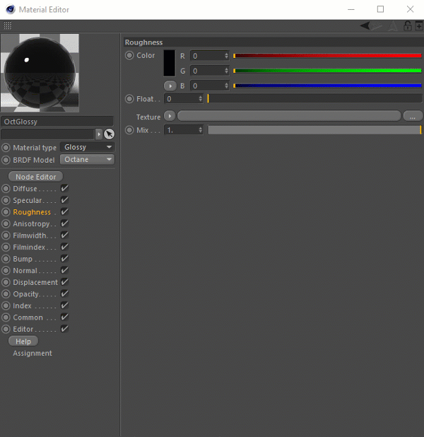

Hi there.
Maybe this was mentioned before.
Once I set the material BSDF to another algorithm the anisotropy behaves as if it was set to 1 although the default in the slider is set to 0. I have made a small screencapture gif:

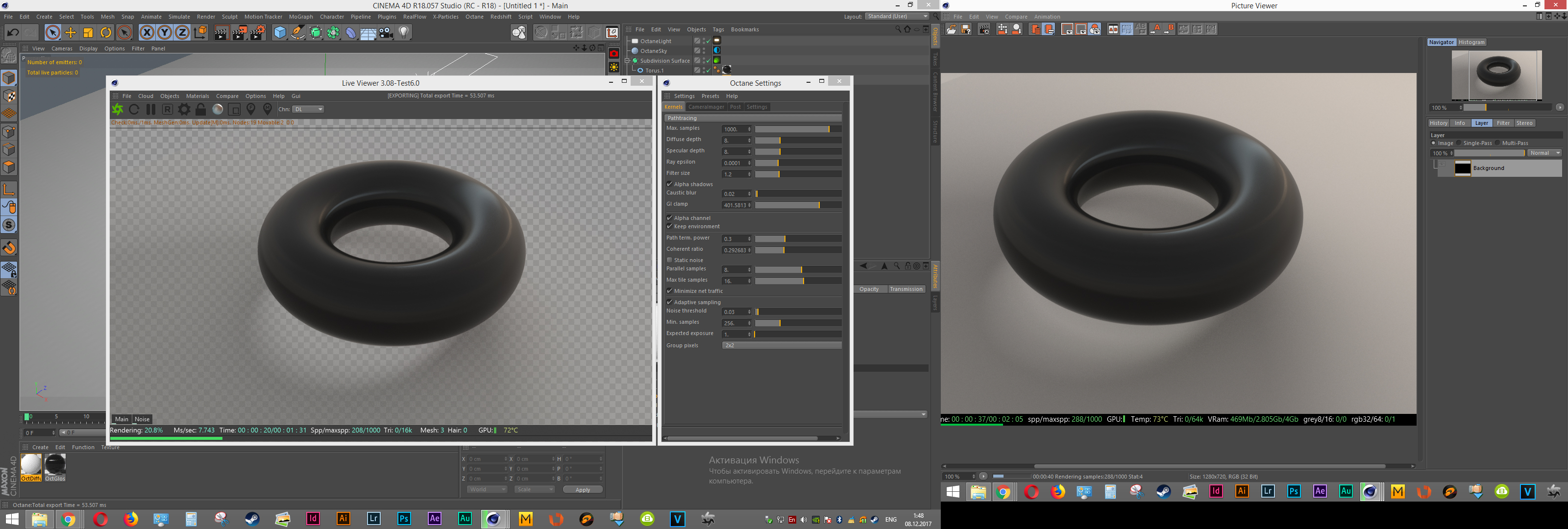

Hi Aoktar. Maybe i do something wrong? I can see alpha in Octane render view, but in Render View not.
rodross
Posts: 135
Joined: Fri Jun 27, 2014 3:01 pm

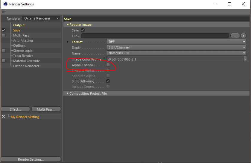

divasoft wrote:Hi Aoktar. Maybe i do something wrong? I can see alpha in Octane render view, but in Render View not.
Did you check "Alpha Channel" in the C4D render settings?
