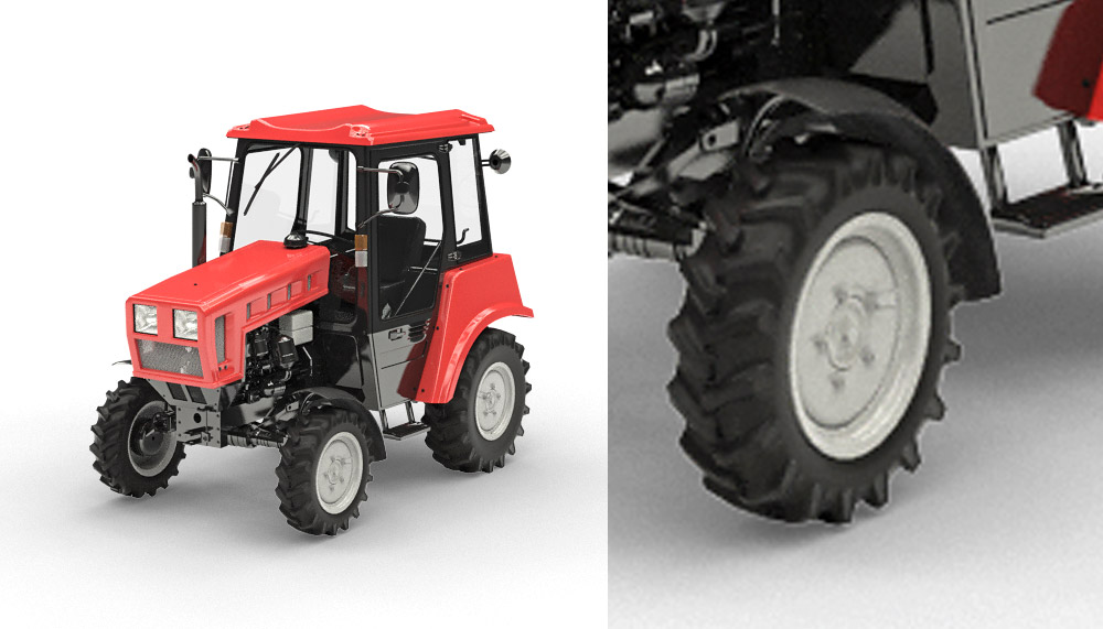

I want leave few questions here. Not exactly about 2.23.2 but about some issues were founded earlier at c4d plugin (with the same results at latest version too).
- When you render object with separate shadow (using render layer feature) and than compose them in photoshop,
there is small unwanted gap between object and shadow.
At some cases and at bright scene with weak shadows it looks like ok, but if you adjust darkness of shadow, gap will come to be visible.
Please look first attachment.

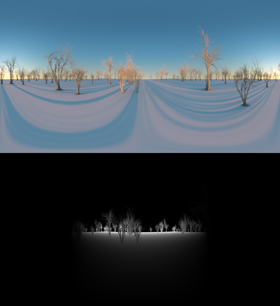

- One more is about zdepth pass with panoramic mode enabled at camera tag.
Zdepth renders just in angle of view of actual camera object but not around like you see scene in panoramic view.
Please look second attachment.
Maybe I make something wrong?

desire wrote:Hi there!
At first I want to say great thanks aoktar for hard work, for a lot of improvements and an angelic patience while you read our again-and-again questions! =)
It's a pleasure, thanks.Btw about surrounding pixels, it was much more on previous version. I suppose that's much better on latest version. I'm not sure it's a wrong usage problem or a mistake on convertion while saving. But i did a sample scene on other topic. see my latest post here: http://render.otoy.com/forum/viewtopic.php?f=30&t=45729
I'll test it more in this week.
