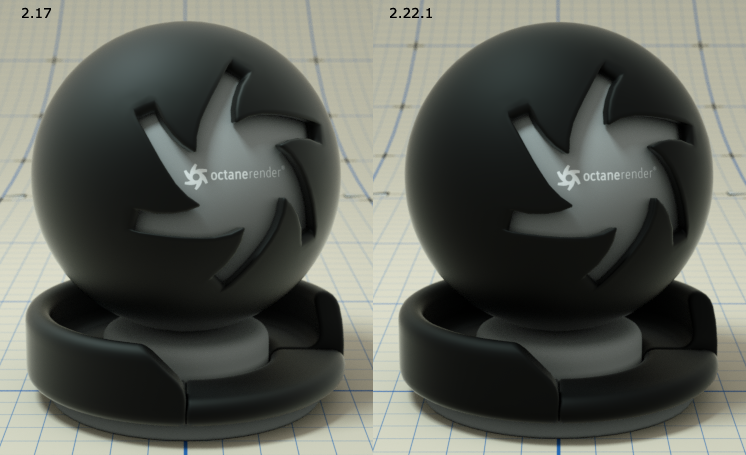

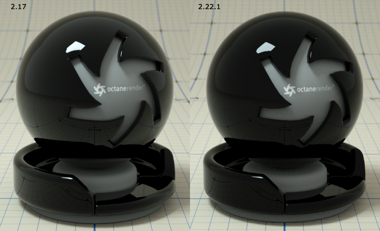

abstrax wrote: [*] Improved Fresnel reflection for specular and glossy materials. Until now the code assumed that the light was always polarized perpendicular to the reflection plane, which is usually not true. As a consequence, the Fresnel reflections were too strong at medium viewing angles (see http://render.otoy.com/forum/viewtopic. ... 39#p227739).
It's nice to see this fixed in glossy materials! I did some tests a while ago and found that octane's fresnel was matching an S-polarized curve, while the other 3d applications I used match a non-polarized (averaged P and S) curve.
I have always adjusted the glossy material specular value down to compensate for the extra bright fresnel in octane, but I may not need to now.
Smooth material using the default IOR 1.3:
Rough material using the default IOR 1.3:

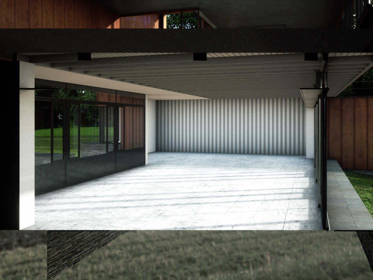

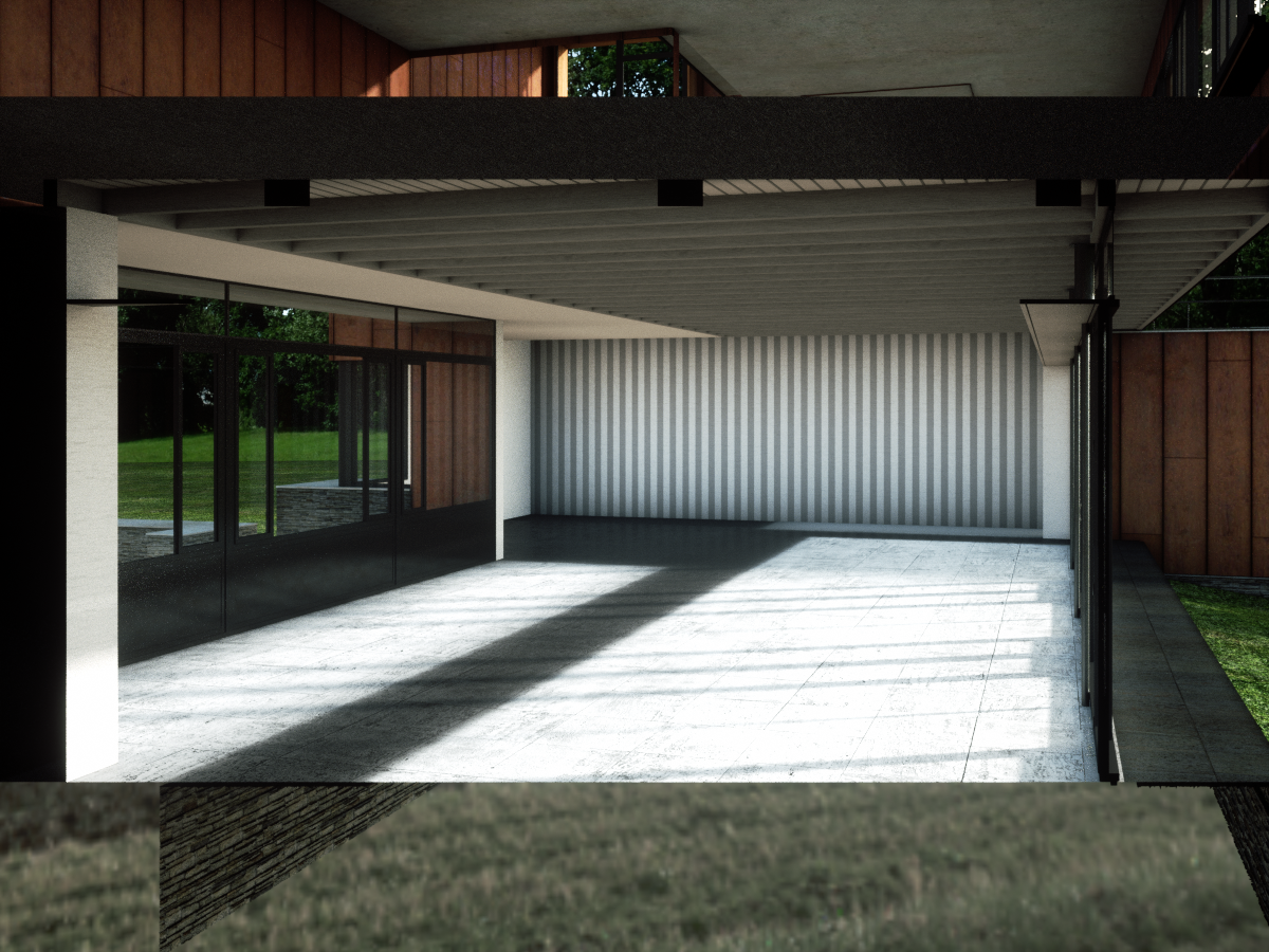

Dirt texture doesn't provide the same result with 2.17 and 2.22.1 (see attached images).
I added dirt texture on the pavement.
2.17
2.22.1
