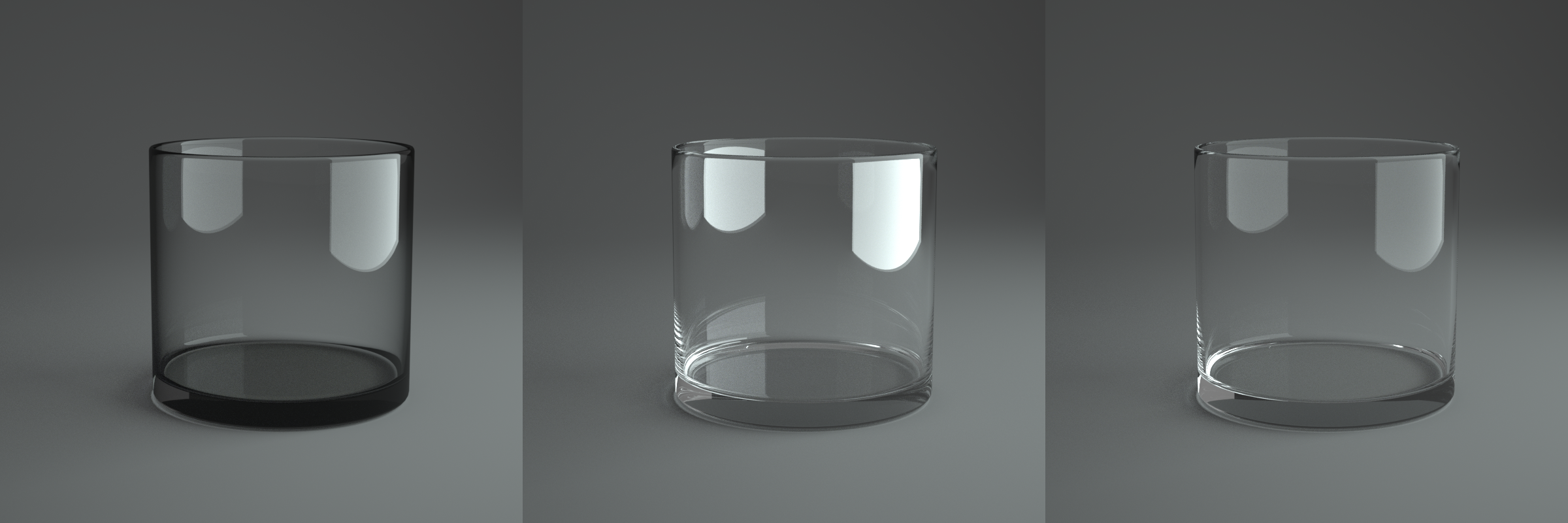

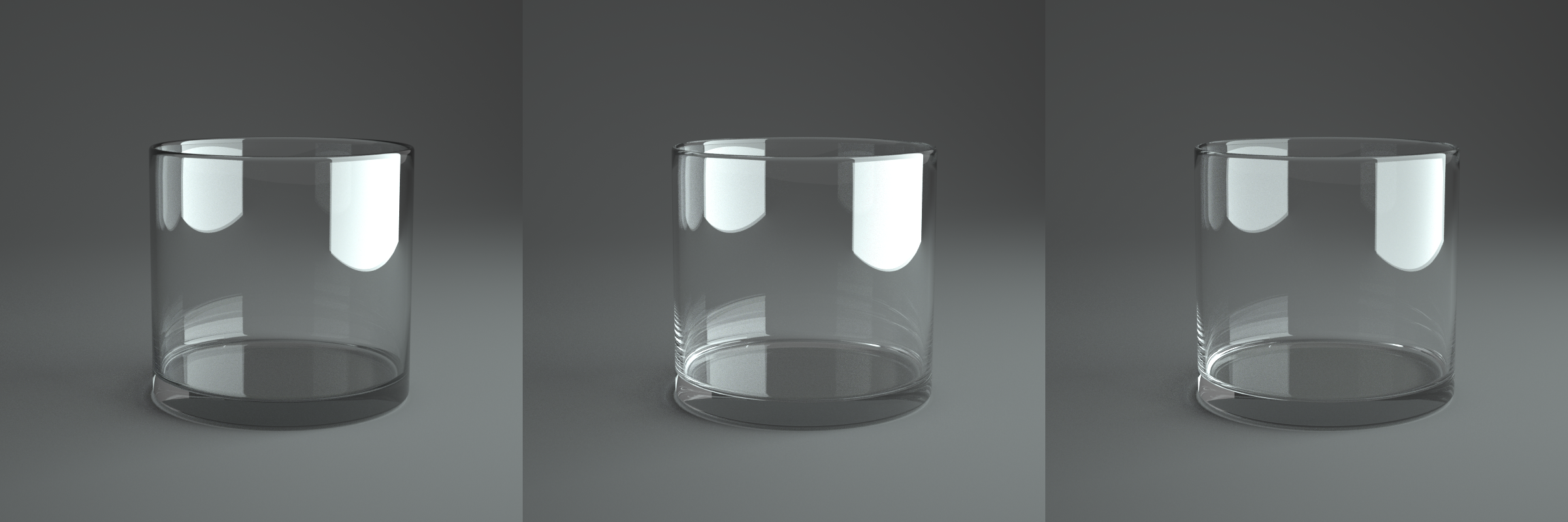

good to be able to have the option if needed though ;) for real though, the purpose of this feature was to be able to lower the reflectivity of specular material, which are very low at normal angles. water, for example is around 2% at normal, which if you set Octane to do this, it would SEVERELY darken the glass material.

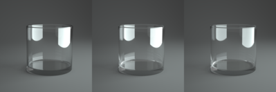

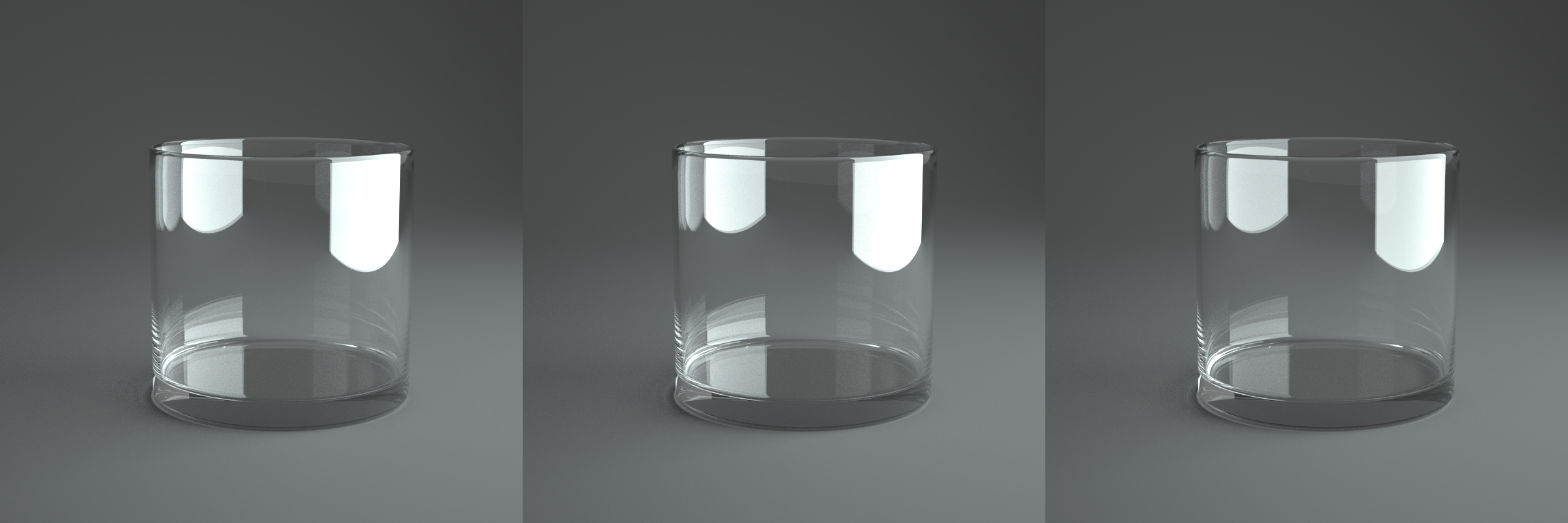

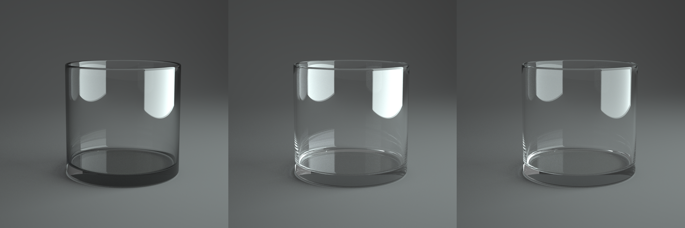

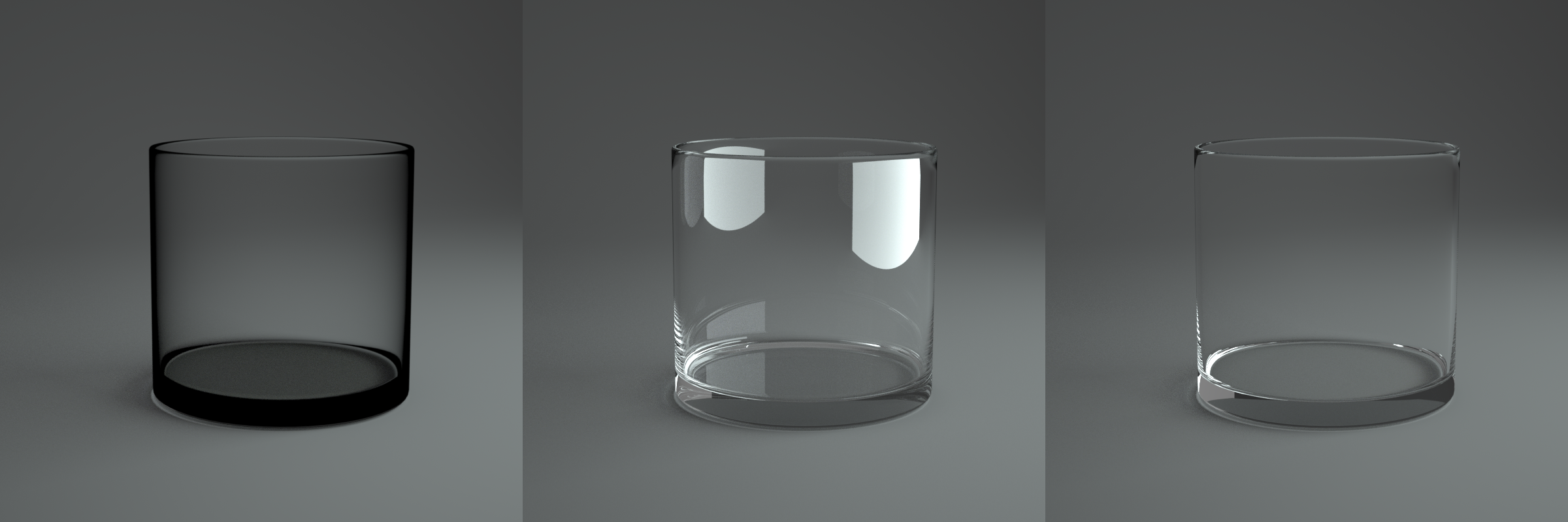

Ok, I have been fiddling around with the specular material trying to improve things. Turns out, that the Fresnel reflection that is being calculated is too bright. It is like all light is polarized perpendicular to the reflection plane (in reality it's usually a mix). I fixed that and also tried to improve the internal reflections. Tell me what you think (the left glass is rendered with 2.21.1, the center glass with 2.22 and the right glass with the (hopefully) improved specular material):
Reflectivity = 100% (transmission is always 100%):
Reflectivity = 80%:
Reflectivity = 50%:
Reflectivity = 20%:
Reflectivity = 0%:

The one on the right looks nice, if you ask me.

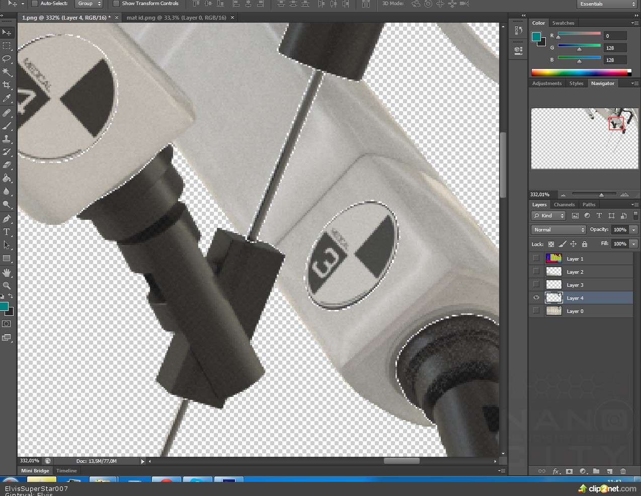

Elvissuperstar007 wrote:http://c2n.me/3eUiCr6.jpg ID layers bug
Isn't that how it's ALWAYS been ( all render engines) with object buffers/ids/mattes? Meaning, bad edges.

The right one for sure !!
Depending on the file format and Photoshop and the import plugin, the alpha channel needs to be pre-multiplied. You will find the corresponding option in the imager settings.
To simplify things, we are developing the Photoshop workflow plugin for version 3, so you don't have to think about these things anymore in the future.

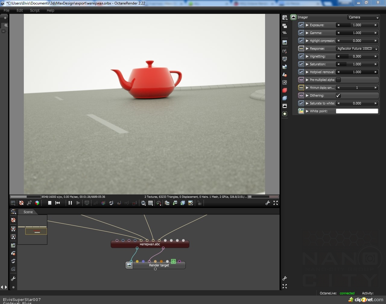

Elvissuperstar007 wrote:http://c2n.me/3eURDGi.jpg
no aperture
If you use the camera of the Alembic file, you have to export the aperture into the Alembic file. In the imager you won't the aperture, that's for sure.
