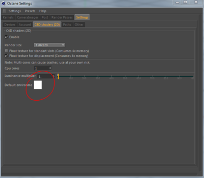

szoraidez wrote:Hi! I have installed the version 2.16 for cinema but the renders and live viewer are totally black... Is working perfect with version 2.12
I am making something wrong?
Additionally, make sure you check the default environment color. It defaults to black with fresh installs. Check the image attached.

Posts: 16068
Location: Türkiye
cyartist wrote:Thanks great tip!
I have notified today, there's a mistake on clean install. it assign as black, will be fixed on next.

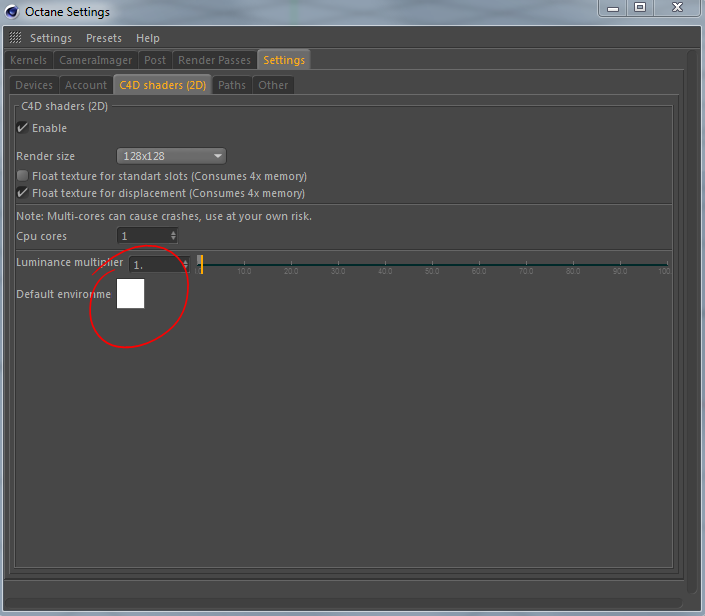

Please don't post on several places. This makes me confused. I think you should set this default environment color as in image.
Also post images to describe better your problems. I cannot estimate what happens.
