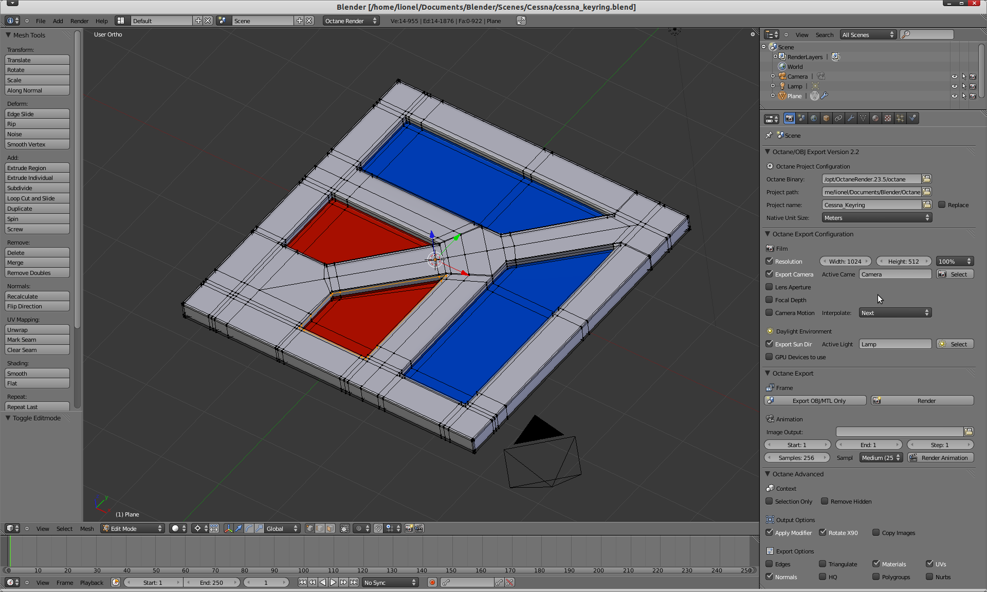

Hi Tungerz,
it looks like you're missing lots of options in the render setup.
You can give a try to the attached script, you should get same as I have on this screenshot.
Cheers,
Yoyoz
Cheers,
Yoyoz
