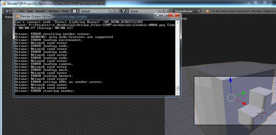

I am having a hard time actually exporting the alembic file. I got it to work once, but now it just wont work.
It renders in my viewport, but when I check export alembic, it doesnt do anything. When I choose animation, it makes all the .pngs, but no alembic file.
This is what my console says.
Does anyone else have a problem getting the alembic file?
