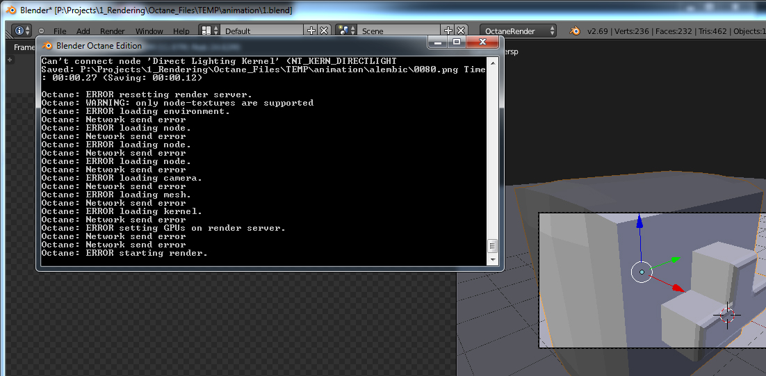

I am having a hard time actually exporting the alembic file. I got it to work once, but now it just wont work.
It renders in my viewport, but when I check export alembic, it doesnt do anything. When I choose animation, it makes all the .pngs, but no alembic file.
This is what my console says.
Does anyone else have a problem getting the alembic file?

Oki, Thanks for this information.aLeXXtoR wrote:Hi!I had this issue too — it seems that this happen when you have not-node-based materials. When I changed all materials in the scene to nodes everything became normal.MattRM wrote:
Also this, when alembic is exported ( when it wants), the alembic haves one materials per frames. exemple, I had 1333 Frames exported and build 1333 materials.
