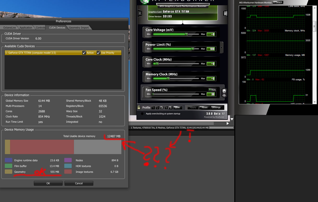

abstrax wrote:
smicha wrote:
manalokos wrote:The program indicates always that memory is 100% occupied 3072/3072 MB but it renders. So memory monitor is not working correctly.
I confirm that too. MSI afterburner shows correct values of varm usage while Octane hits incorrect 100%.
Does it happen all the time? If yes, what exactly does the memory usage say (all 3 numbers) and what is reported in the CUDA device tab of the preferences dialog?
Actually I don't know when exactly it happened but it did. Here is the screenshot. And what funny is that total vram for my Titan is 12GB - nvidia was so generous giving me extra 6GB :) Seriously, after reloading the obj all went back to normal.

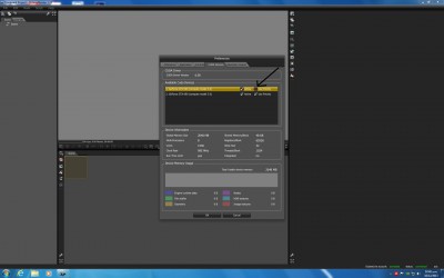

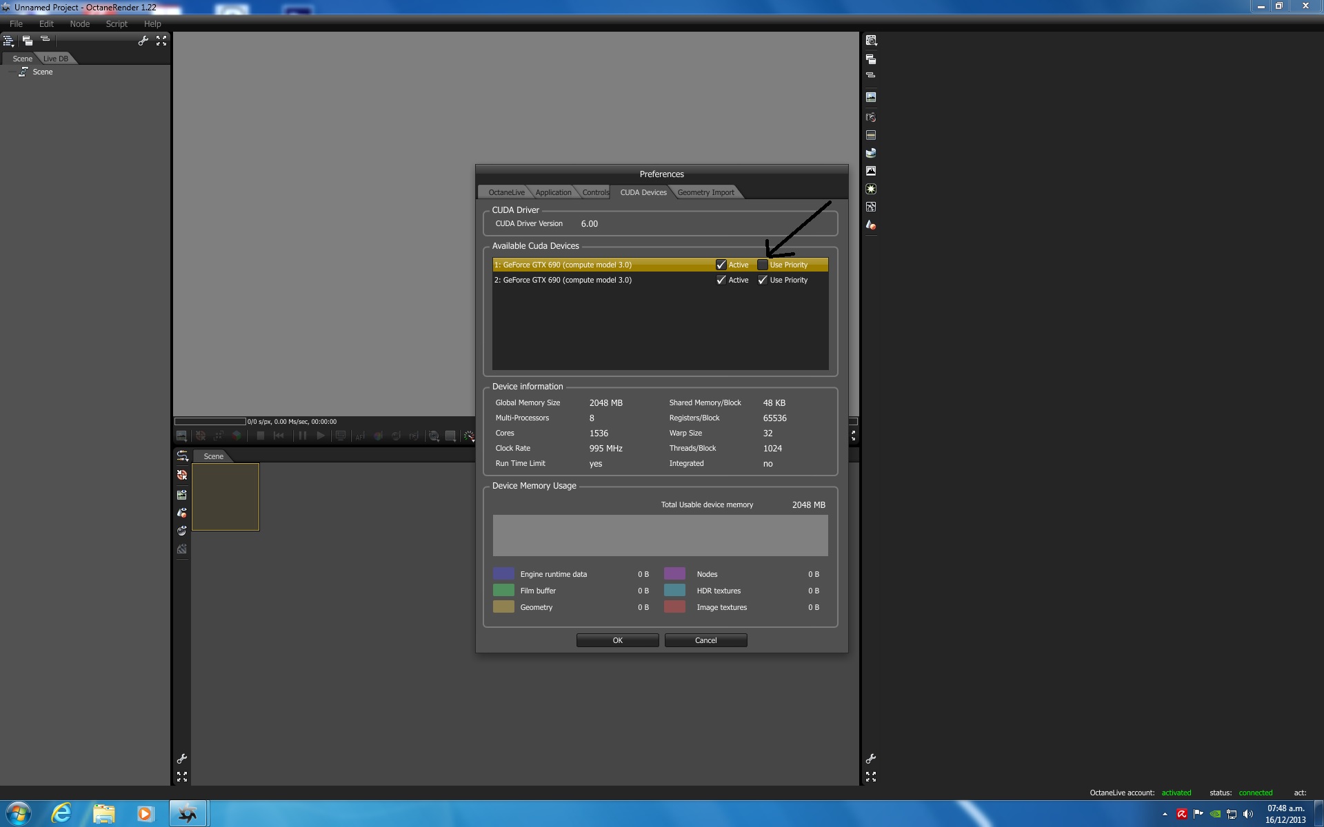

hi roeland is normal this part ? uncheck the box, can you help me ?

merid888 wrote:hi roeland is normal this part ? uncheck the box, can you help me ?
Well you can check or uncheck this box by clicking it. Normally you check this box for any GPUs connected to a display, to avoid the GUI getting too slow.
Roeland
