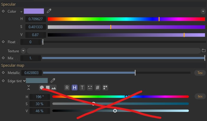

I noticed next interesting think about nodes. Generally all of them works the same way while moving sliders - when we stop move slider renderer is going to render image to fully max samples. The only difference are gradient nodes and color sliders - they not render until we release mouse after moving slider :)
Changing color GUI type to Octane native resolves color sliders but it doesn't works for gradients.
Generally these top and middle sliders works fine in Octane Native GUI but not these bottom and gradient too ( gradient and color sliders in gradient nodes ) :

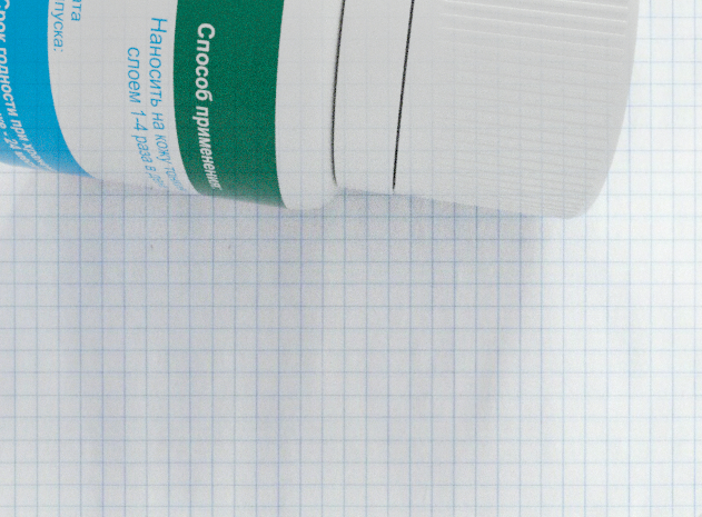

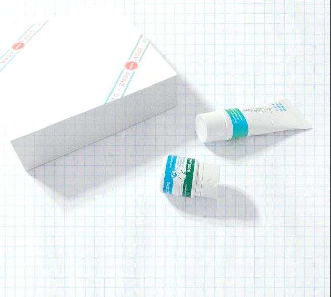

Have used a few times projection node called Sample position to UV
Very useful. But... I rendered one time all is fine, saved the scene... After few days open the scene, send to LV and get semi transparent objects (in their shadow area) - please see screenshots.
Here I put with background to see clear this effect. Reassign material isn't working. Creating new plane & new material too - giving the same result.
The result in a PV and through Render Layer gives the same semi transparent objects.

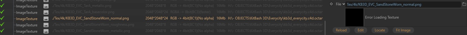

aoktar wrote:
SSmolak wrote:Relinking textures using Project Asset Inspector doesn't work anymore. Using Octane Texture Manager is very slow.
Without giving more details about your scene/texture informations and paths that's not much useful.
Please see, after proper relinking using C4D Asset Broweser proper texture paths are included in Octane Texture Manager too but not in Texture Nodes.
