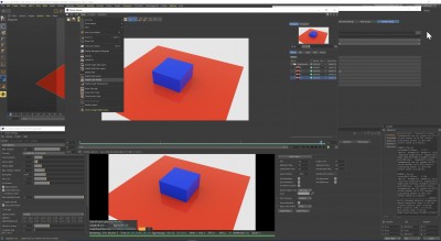

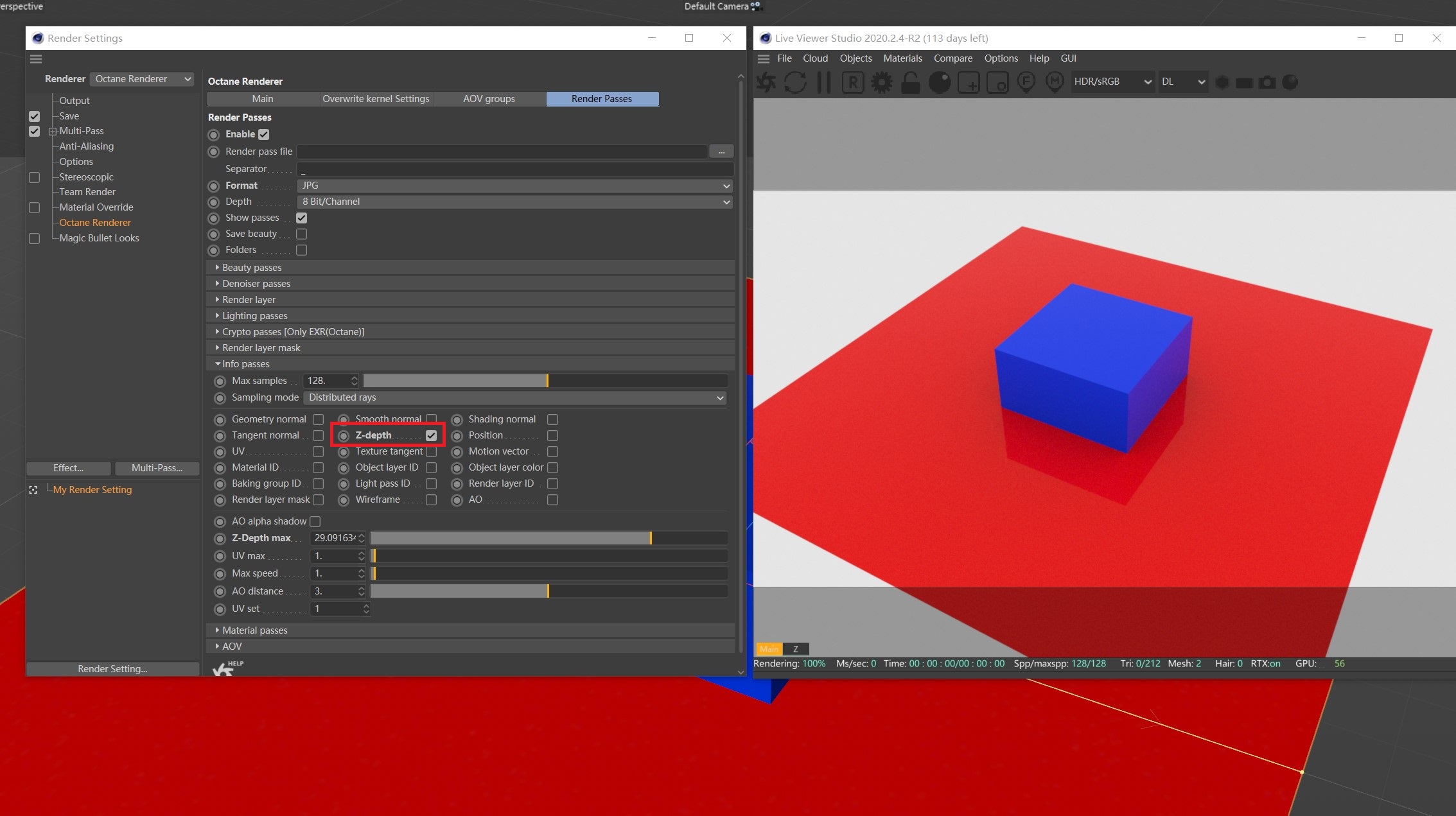

Thank you ahmet for the hard work, currently there is One more annoying bug remaining in the latest stable build.
I created a simple scene to demonstrate this problem, attachment below.

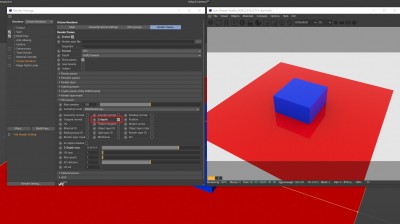

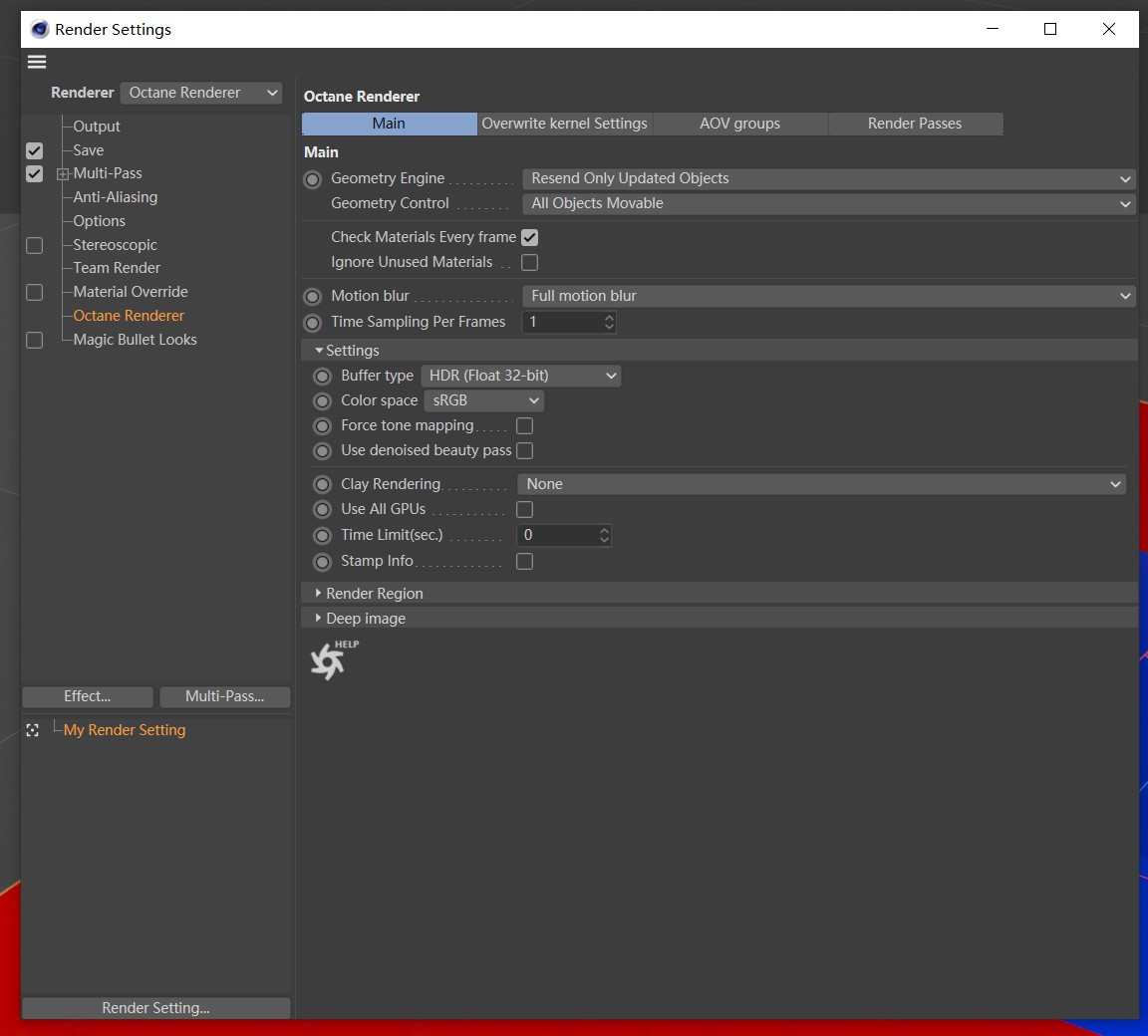

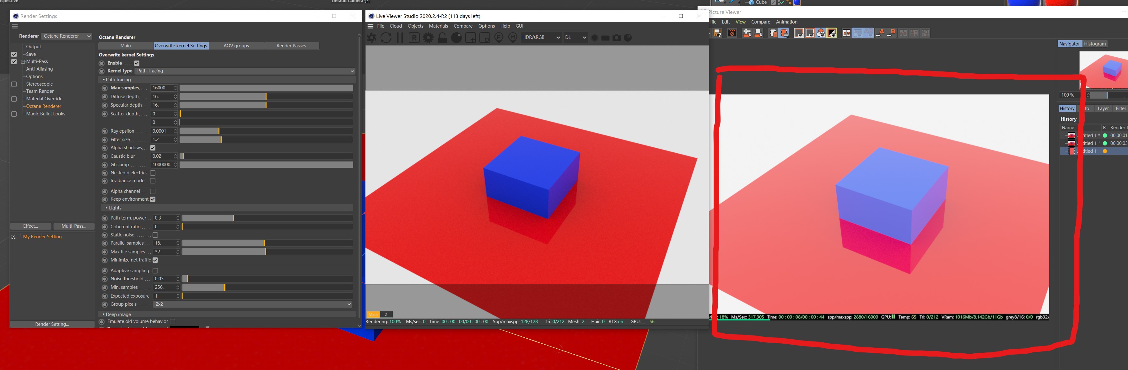

When exporting beauty with Render passes enabled, especially with Z-depth turned on. The output image in C4D picture viewer is desaturated and its gamma is way off comparing with Live viewer.
The settings are shown in picture 1 and 2. The result shown in 3.
Am I setting stuff wrong? Octane doesnt have this problem before.
As you may see, here is the tricky part, after each frame rendered, the final result of rendered beauty sometimes is correct (same as live viewer) But sometimes the rendered image file is just messed up picture viewer shown!
And here is the worst thing, the Octane will constantly crash rendering heavy scene with animation and Z-depth turned on for some reason. Disable Render passes render completely, problem solved. I think there is definitely something going on with the newest implement Aov system has to do with it right? How to make my Octane not crash?
Thank you!

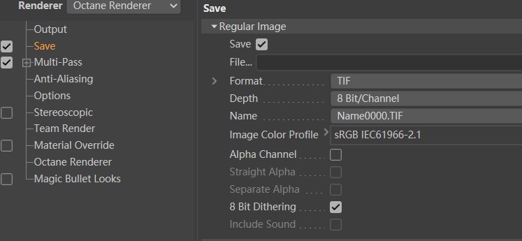

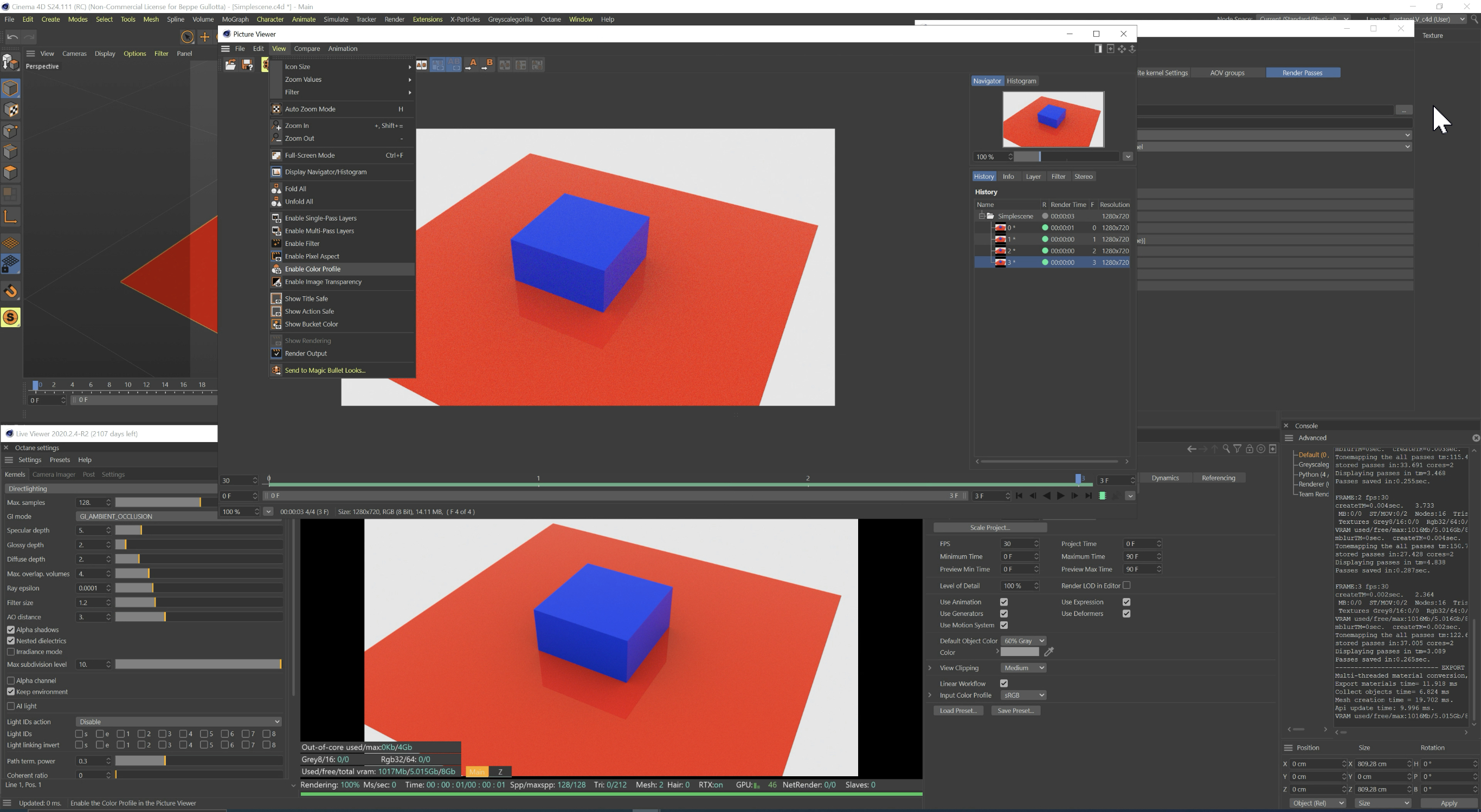

try to disable the Color Profile in Picture Viewer/View menu:
and avoid to save from C4D Save panel, and use the Octane Multi Pass tab instead.

bepeg4d wrote:Hi,
The attachment AA9FB249-AAEA-4645-B897-88CB9FB54041.jpeg is no longer available
ciao Beppe
Cheers mate ! Yes I use octane render passes panel to save passes no problem. Do you mean I should use that tab to save Beauty or final render from that tab as well? and leave everything blank in the normal C4D save panel?
Thank you!
Thank you!
Posts: 10606
Yes, in Multi pass mode, avoid to use the C4D Save panel, and save also the Beauty pass from Octane Multi Pass tab.
In this way, all the passes will have the same coloring treatment.
ciao Beppe

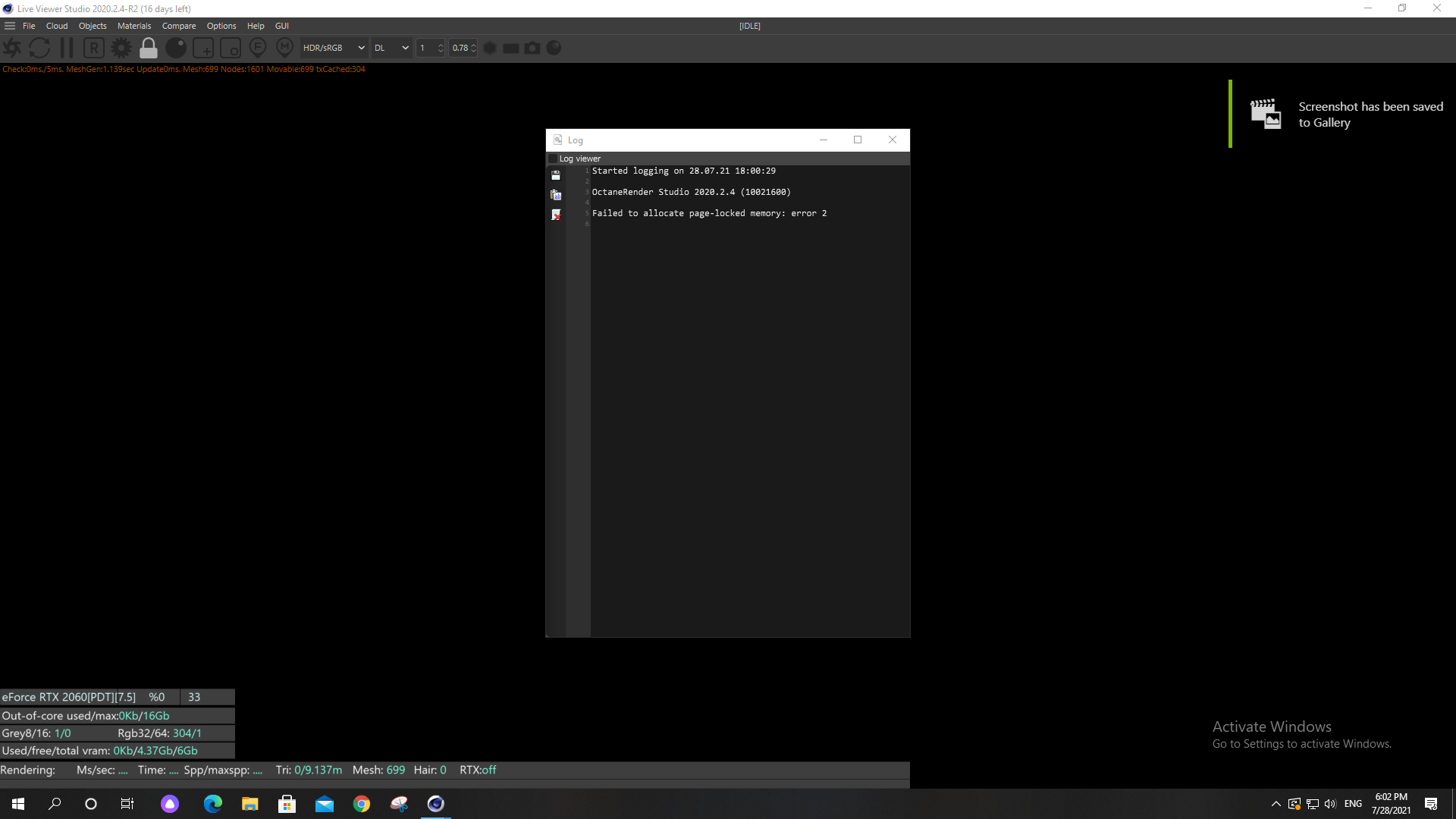

Hello, my first month with octane, i like it very much, but i have this problem. It basically shows up, when i add smth or edit in my scene, and to solve it i have to save my project after editing and re-open cinema, it's kinda annoying to do that eveerytime, so i hope you can help me. Thank you very much!!!
