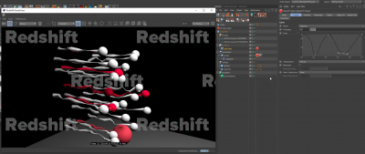

Can you please provide an example which works with RS? Putting a support for xp is not my only work and It should not be called as "fix". Every extra feature may require a lot of extra work.thanulee wrote:Hi,

ALSO color information is lost if you use deformers under xpTrail. Don't you have an alternative way for doing same with xp effects?
Xp works in a lot of ways regarding deforming splines. It also has an xptrail deformer for this same purpose. And this one breaks color as well. Deforming splines is fundamental to achieve all shorts of effects without making em dynamic. We already have limitations with native hair and octane hair so this adds on top of the things that cannot be done.
Having color on the splines only under the most basic condition eg. particles emit and a turbulence, is something that would rarely go into a client job. It's not applicable in the majority of cases for anyone that uses XP in production.
Also the grouping thing is really important. And while group color is passed on the material, object ratio doesnt. And this makes things difficult down the line when xp setups become complex.
I understand that XP is a plugin but its the biggest plugin in C4D and took a very long time to access their API cause this was the reason features were not implemented as I recall. Right now the functionality of octane vs RS is not comparable in many ways when it comes to XP. I am not suggesting to make everything work as in Cycles, but splines having the color of the particle when deforms is basic for any design purpose. Same as grouping and ratio, not being able to control how particles look in general is basic.
All studios I work with prefer Redshift for that flexibility and I keep losing projects out of that
Please consider looking into to all that. Rendering xp with octane is a constant headache for me, no matter how many different approaches i take for my setups.

Asked for a RS version of this scene. I'm curious how they can read colors in case, because it's a xp API problem. I don't think they are doing with APIthanulee wrote:I did, i provided a scene that cannot do the things i mentioned. Both in same scene, groups and colors on trails.
