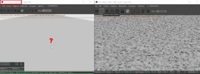

Vectron Bug.
Bug1
Open C4D - Create Vectron Object ---> Crash
Open C4D - Open LV - Create Vectron Object ---> Ok
Bug2
I Use Vectron - Procedural Terrain(Slow).osl
2018, 2020 is Ok.
2019.1.5 can not be applied Noise Texture .
