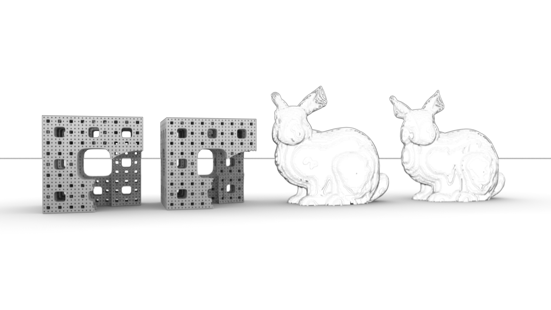

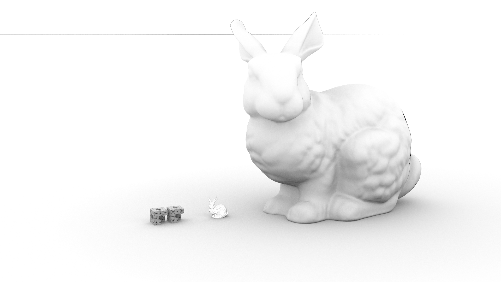

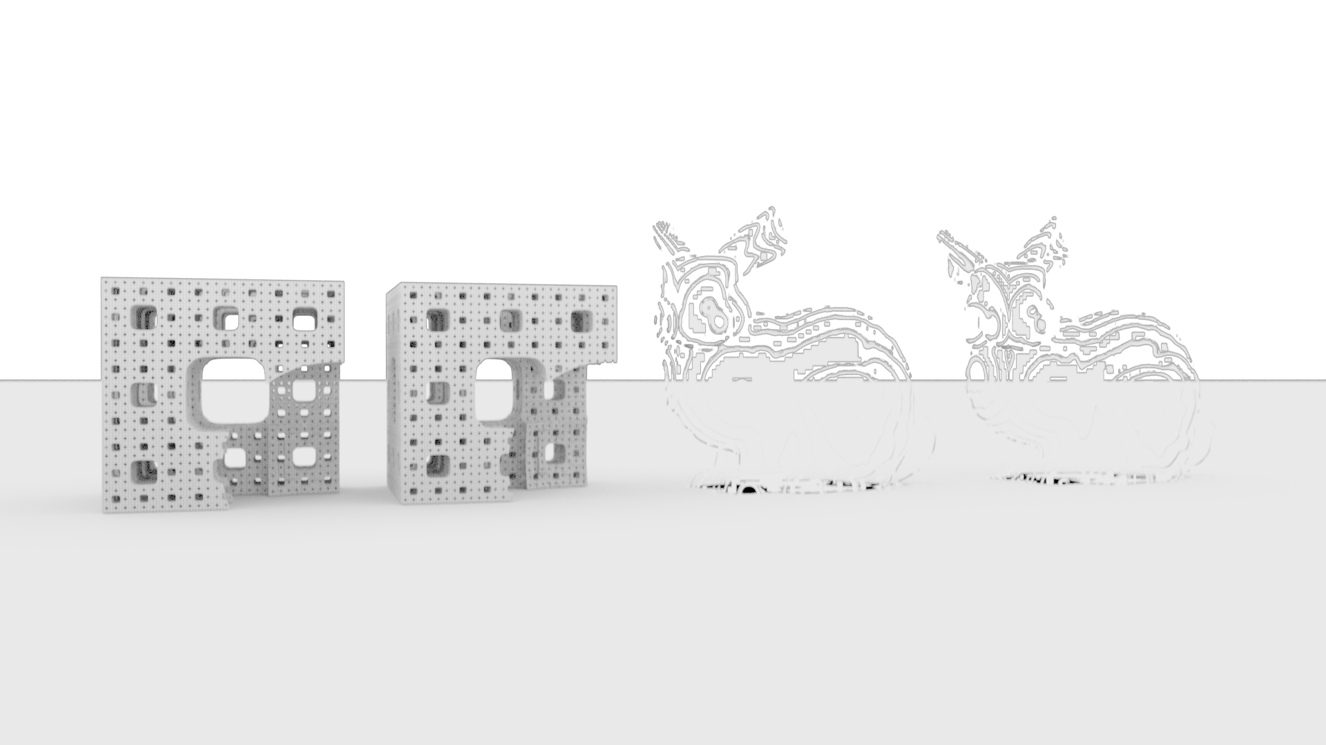

Hi Guys,
We have a Problem with Scale with SDF meshs I guess is link to scale, I created a scene in Maya (cm unit) and the scene scale 4 meter scale, I know Maya plug still struggles with Scales and by breaking all the idea of real size world setup and etc, Anyway I realize when I export to standalone small size files with SDF is weird maybe wrong settings please any help? (Maya Post = viewtopic.php?f=109&t=70282&p=354835#p354835)
Cheers,
JO
PS I remember at 3.08 we had a issue similar with Displacement not be rendered correct with small size scenes and then was Fix, Could be the same case? the funny side is as you can see vectron mesh is all good
I through was the same. Well could be settings I don't know.
Cheers,
JO
- Attachments
- SDF_Vectron_Sizes_Orbx.rar
- Standalone Scene
- (37.26 MiB) Downloaded 286 times
- SDF_Vectron_Sizes_Maya.rar
- Maya Scene
- (14.08 KiB) Downloaded 215 times
Octane Render for Maya.
https://vimeo.com/jocg/videos
http://www.hmxmedia.com/
Thanks for the report, we've fixed a few problems in this area, and there's another issue being resolved right now related to volume SDF scaling, most likely this is what you are seeing.Jolbertoquini wrote:Hi Guys,
Cheers,
JO
PS I remember at 3.08 we had a issue similar with Displacement not be rendered correct with small size scenes and then was Fix, Could be the same case? the funny side is as you can see vectron mesh is all good :o I through was the same. Well could be settings I don't know.
Hi Haze,haze wrote: Thanks for the report, we've fixed a few problems in this area, and there's another issue being resolved right now related to volume SDF scaling, most likely this is what you are seeing.
Another issue with Vectron is the missing local space, shouldn't a matrix attribute for local space be added to the struct ? and also maybe the bounding box parameters ?
maybe this could also solve the broken manipulator with Vectron geometry ?
Or is it a limitation on purpose that Vectron should only work in World Space ?
Pascal ANDRE
I assume you mean volume SDF? I'm not really fully sure what you mean. For volume SDF we don't have to have a bounding box pin because there is one defined by the VDB. The issue with vectron is that it is an implicit function (ie has valid values everywhere). We have to have a limitation, but it's not obvious from the code, which is why the node has the bounds in it. Hopefully we will come up with a better solution for that.calus wrote:Hi Haze,haze wrote: Thanks for the report, we've fixed a few problems in this area, and there's another issue being resolved right now related to volume SDF scaling, most likely this is what you are seeing.
