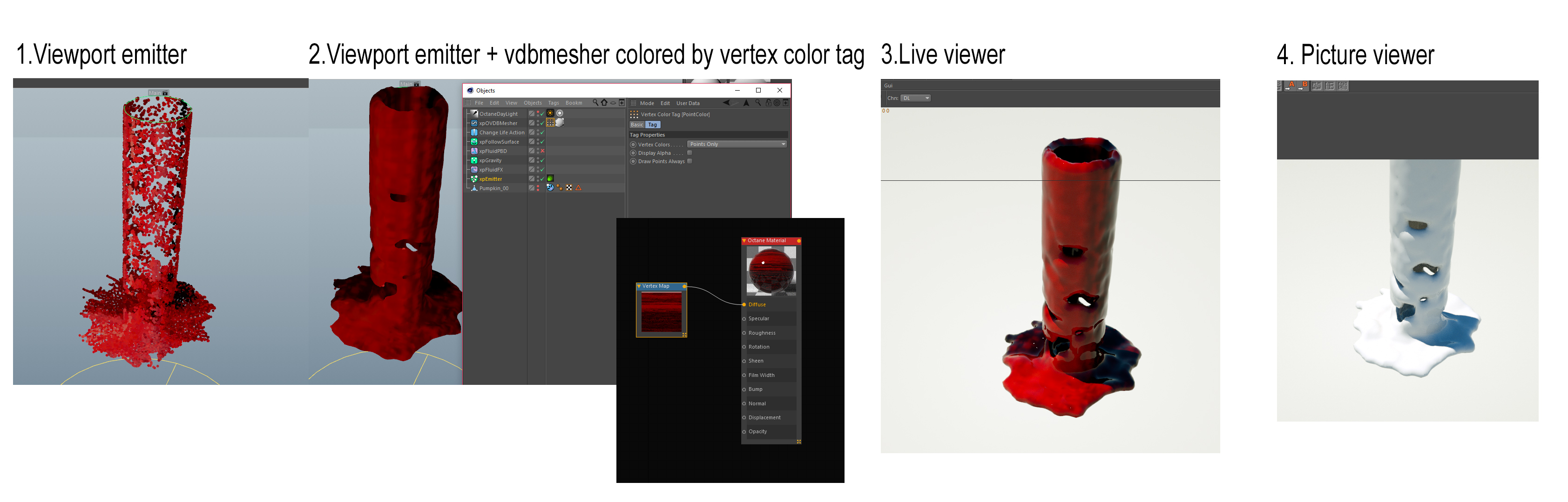

Hello Aoktar,
I'm in a situation where the render in the live viewer is different than the picture viewer.
Let me explain
With Xparticles, I'm emitting particles from a shader, then I'm meshing these particles with an Ovdbmesher.
I'm using the vertex color tag in the diffuse to have the vdb colored. In the LV no problem, but in the final render, the Ovbmesher has no color.
Here is a preview of my workflow. Can you tell if I'm doing something wrong ?
Thank you
Let me explain
Thank you

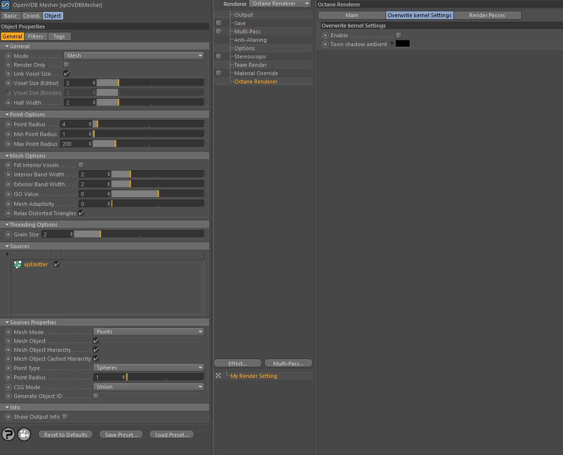

Did you changed with render settings? Show me pls if so!FxDesign wrote:Hello Aoktar,
Let me explain
