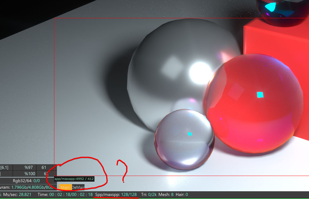

denoised beauty render pass dont work with render region in Standalone?
viewtopic.php?f=85&t=68833&start=30#p346432
and
in render Viewport/LV with render region dont stop calculation sample value in scene?
how to set the limit in the settings?
UPD: i found topic viewtopic.php?f=30&t=56028
but
make in the settings for the user the checkbox limit maxspp now always GPU load 100%
thanks
in RS/Cycles4d works fine (limit clculation)

Interactive render region will render up to 1 million or until stopped. For this specific reason, we have an option to denoise periodically. Disable denoise on completion option and set the desired interval to denoise periodically.
