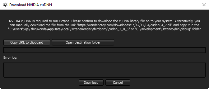

When starting Octane for the first time, you'll see the following window:
EDIT:
Occasionally when we upgrade cuDNN, you may see this again at a later date. You can simply click Download and Octane will download the file needed. If you have any trouble with this process please let us know. If you need to, you can manually download the file and copy it into "C:\Users\<user name>\AppData\Local\OctaneRender\thirdparty\cudnn_7_0_5" folder so all octane builds (standalone and plugins) can load it or in a particular build folder(eg: standalone installation folder), but only that particular build can load it.
If you need to download the files directly yourself, we include links here for convenience:
cudnn64_7.dll for Windows
libcudnn.7.dylib for Mac OSX
libcudnn.so.7.0.5 for Linux

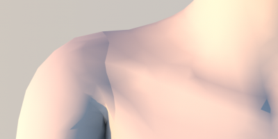

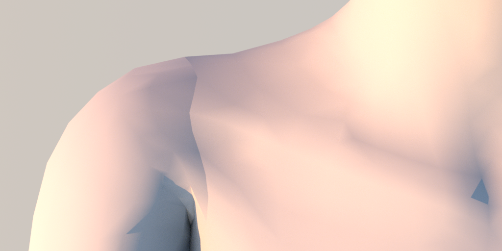

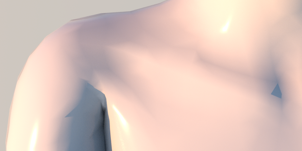

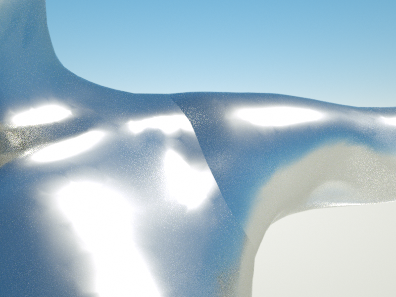

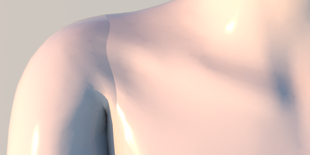

Not sure if this is a bug. If it is, it has been going on since all versions I have tried (3.02 and >).
But just looking for some thoughts as I am seeing this in RC4...
Imported ABC character, my images will show 2 materials connecting on a figure, for (1) arm and (2) body.
In these images the 2 materials are set to a default Glossy.
ISSUE - When I subdivide the mesh in the ABC geometry file settings, there appears to be UV warping between the 2 material sections of the ABC.
Occurs whether Diffuse, Glossy, etc.
With SubDivision OFF
With SubDivision On
This doesn't happen with all characters I import, but I'm wondering if a particular ABC might expose an issue that is in fact there.
Any reasons why the SubD would cause, what looks like, a UV warping, but with said warping not being there when there is no SubD applied?
EDIT -
I unchecked Load Vertex normals, and then it appeared when there was no SubD applied.
What might this mean, in context with the above. :oops:
EDIT 2-
I exported the original ABC to 3DS Max and used the Octane Plugin to then export the scene to standalone, and the issue was there too.
This is the export from Max plugin, with one singular mat, I made it specular.
So this makes me think, it's a Geo problem somehow? Because how could 1 material be warped, right?
BUT...
what I'm thinking is that Octane has a way to overcome this, as the checkbox for "Load Vertex Normals" corrects for that.
And maybe the issue is that it only works without Subdivision, but is not working with Subdivision?
THX.

Notiusweb wrote:Not sure if this is a bug. If it is, it has been going on since all versions I have tried (3.02 and >).
Try the "Welding" setting when importing the abc file.

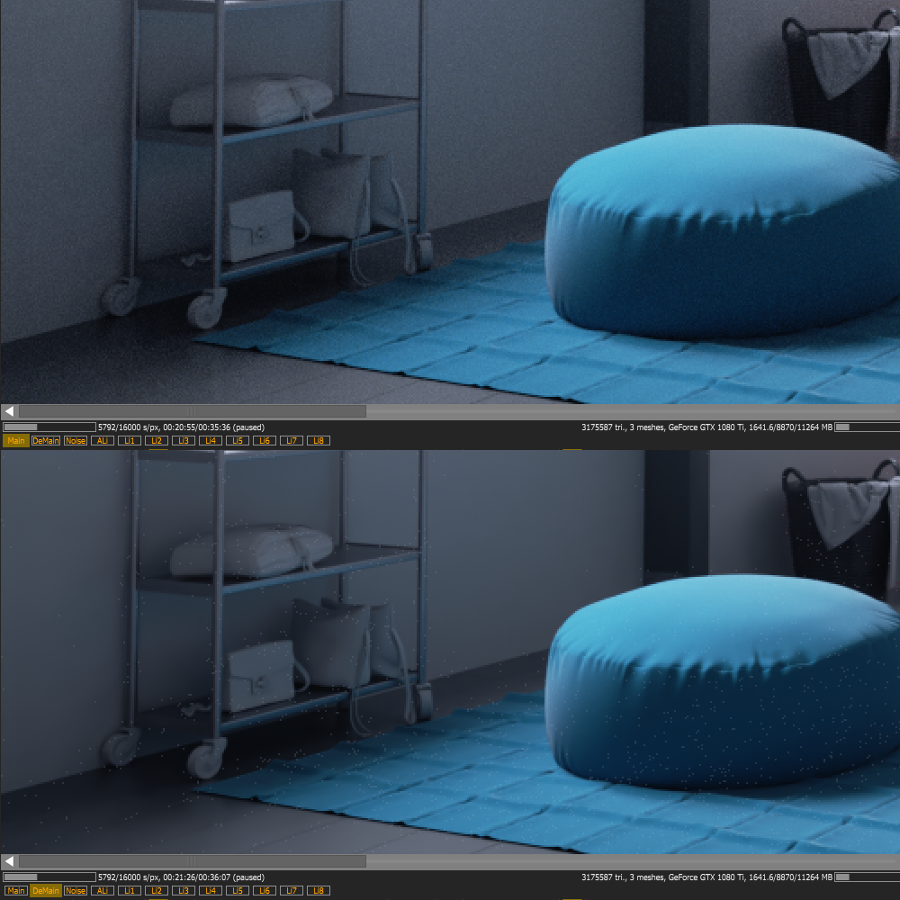

I'm just messing around with a scene where the denoiser is running every 20 seconds or so.
I noticed the result looks quite clean, but has random dots in several areas. It's a bit too big to attach to the forums.
(EDIT: I PMed a dropbox link to haze. Let me know if I should send it somewhere else)
Here is what it looks like (ctrl+zoomed in to make it easier to see). It looks the same even after rendering for 20 minutes
