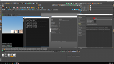

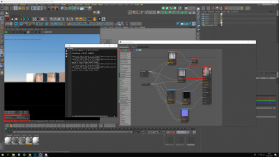

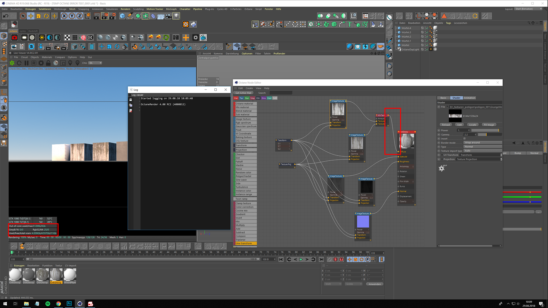

made a test, also with software open GL, CUDA error 700:

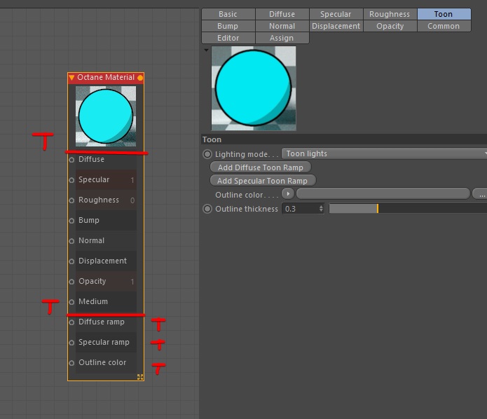

Ahmet,
you need to add more ID that it's Toon mat
see variant

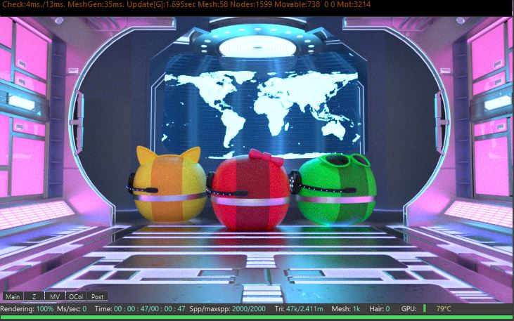

Hello Aoktar,
I have the same problem than "stefano-dear"
The render times are really longer in the latest version (4.0 RC2 R1) than the 3.08.1 version.
Here are the screenshots:
v3.08: 0'47 sec
v4.0 RC2 R1: 3'46 sec
I've just loaded the scene in both versions.
Do you know why the render times are so longer ?

FxDesign wrote:Hello Aoktar,
v3.08: 0'47 sec
It's confirmed that V4 is slower while you have a lot of movable meshes. It's most likely fixed on new SDK.
