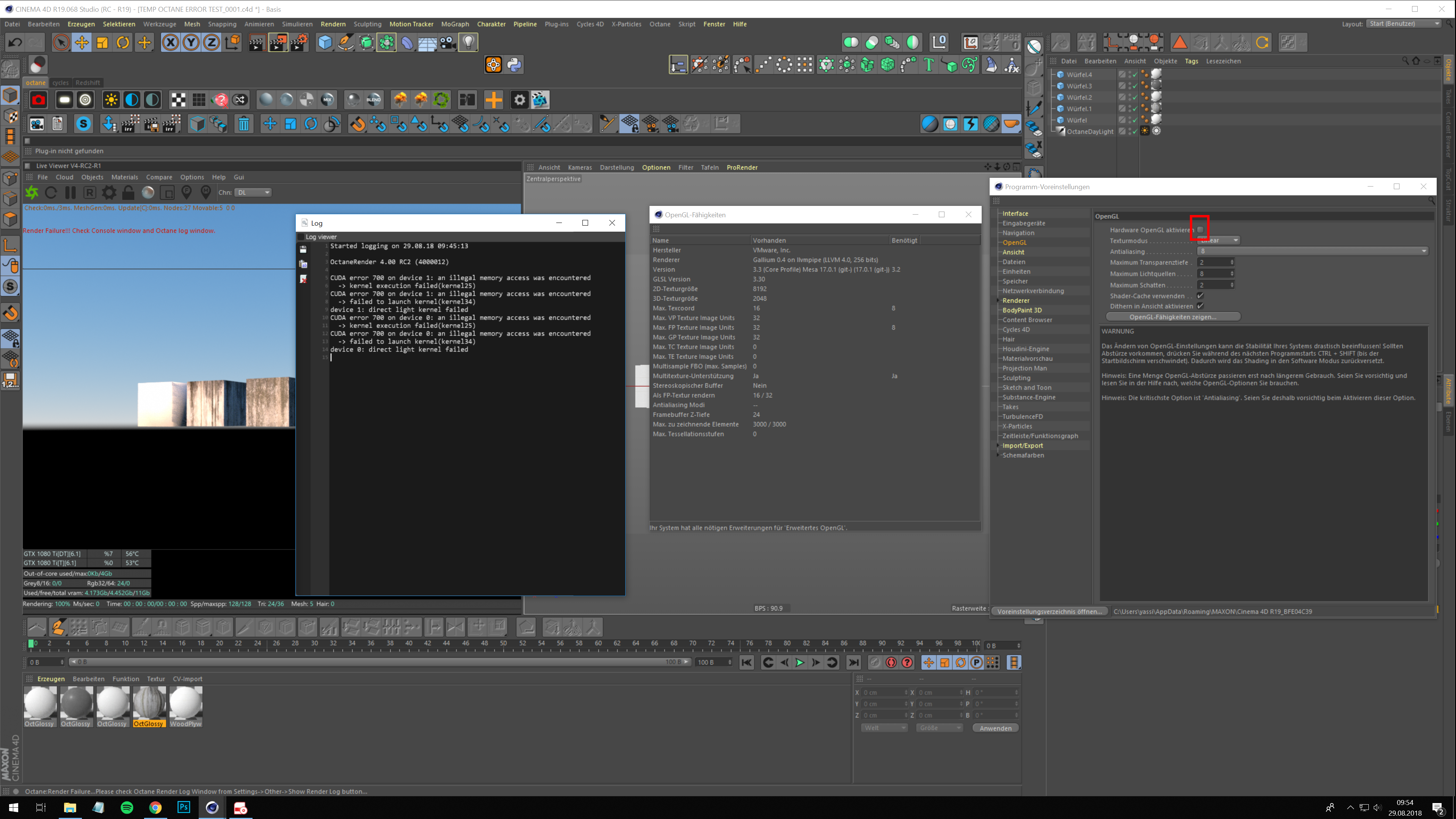

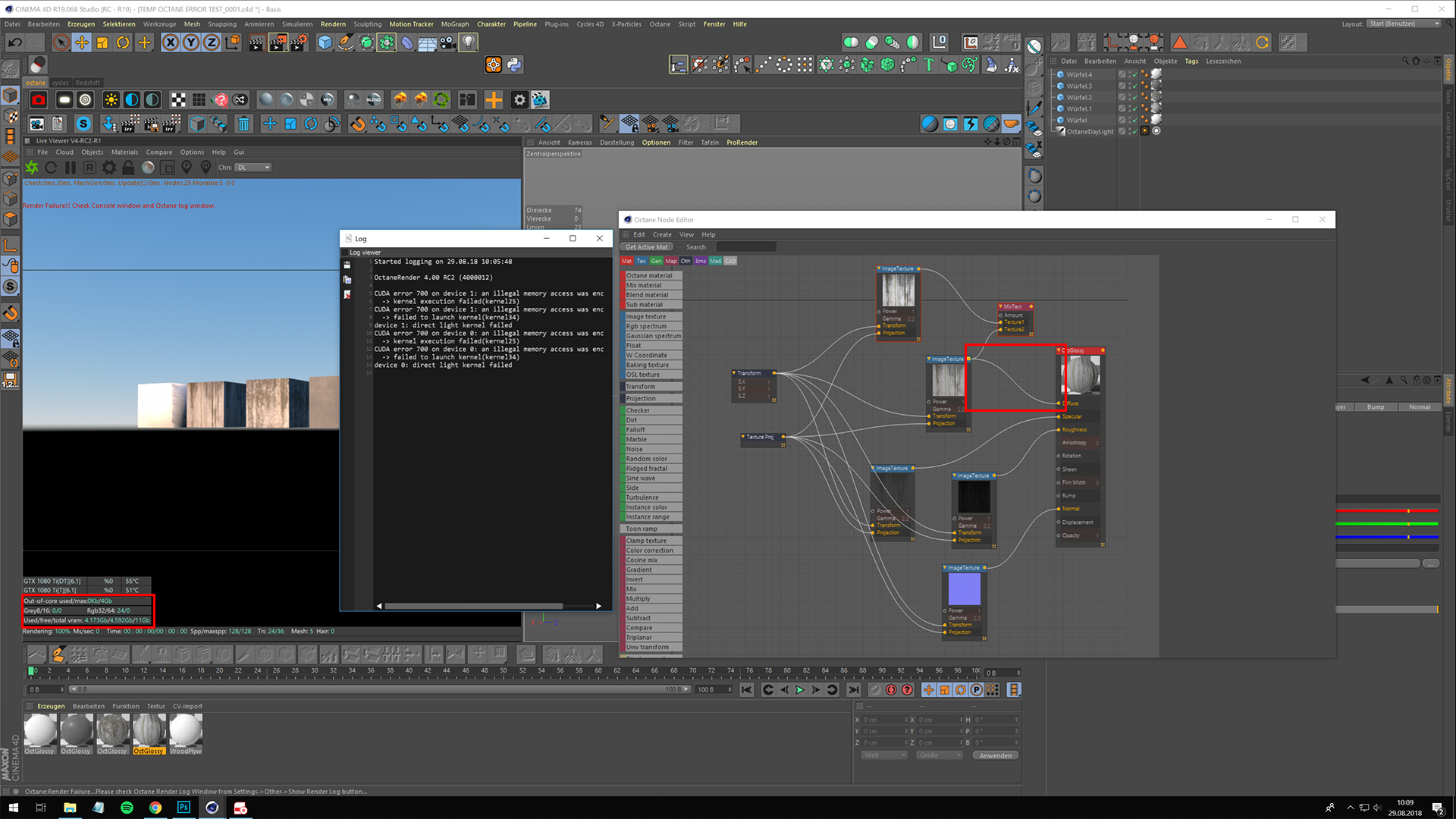

made a test, also with software open GL, CUDA error 700:aoktar wrote:Plugin's itself is not having any cuda software. It's built over standalone core. So it cannot be an issue of plugin alone. Maybe some conflicts between C4D opengl and octane core's cuda structure. Try with software opengl mode to have more ideas.y81r wrote: I have tried several different Nvidia drivers, and removed the old ones before testing a new diver, without any improvements.
It must be a problem of the plugin and not of the standalone core.
I'm not the only one with this problem so I hope you can help us.
This is my setup:
Win10 Pro
Mainboard MSI (MS7A78)
IntelCorei7-7700K 4,20 GHz
32GB RAM
2x GTX1080ti
c4d r19.068
Octane V4-RC2-R1
Thank you for your hard work!
Yassin

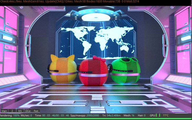

It's confirmed that V4 is slower while you have a lot of movable meshes. It's most likely fixed on new SDK.FxDesign wrote:Hello Aoktar,
I have the same problem than "stefano-dear"
The render times are really longer in the latest version (4.0 RC2 R1) than the 3.08.1 version.
Here are the screenshots:
v3.08: 0'47 sec v4.0 RC2 R1: 3'46 sec I've just loaded the scene in both versions.
Do you know why the render times are so longer ?
