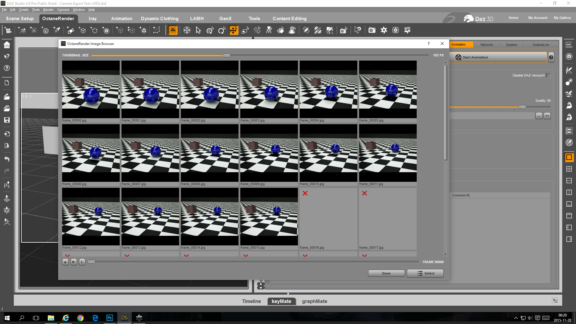

@ 09 Exporting Animated Cameras to standalone Only still cameras seem to be exported from OcDS to OR standalone
compare:
viewtopic.php?f=44&t=49315
This should be fixed in the current 2.24.2.1 release if you export to ABC.
Retested with Prerelease 0 OcDS 2_24_2_3.
Confirmed: camera export as .abc from OcDS System tab is working.
- camera .orbx export: not yet working
- export complete scene with animated camera as .orbx: not yet working
This means currently as a workaround for still scenes with only camera movment you can:
- export the scene as .ORBX
- export animated camera as .abc
- combine in OR standalone
Update / Edit:
Scenes exported as .ORBX do not include key frames for objects animated in the DAZ Studio time line. :!:
For scenes that include objects animated in the DAZ Studio time line I currently am not aware of a workaround how to export them with all movement to OctaneRender standalone.

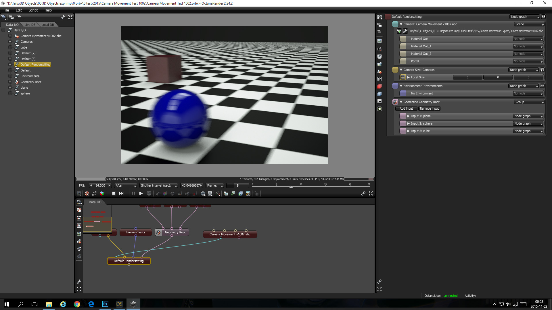

08 Camera & Object Motion Blur
- Object Motion Blur not working
- HDR background has no camera motion blur at all
- When the camera is rotating no camera motion blur is created
compare:
viewtopic.php?f=44&t=49118&p=244278
Retested with Prerelease 0 OcDS 2_24_2_3 to check if the status is accurate.
- Object Motion Blur not working at all in OcDS - reconfirmed
Camera Export Test v1003 Camera & sphere movement
The camera motion blur limitations are probably OR standalone related issues.
Will check with OR 3 standalone beta version again what camera motion blur is doing when rotating cameras and using HDR backgrounds.
