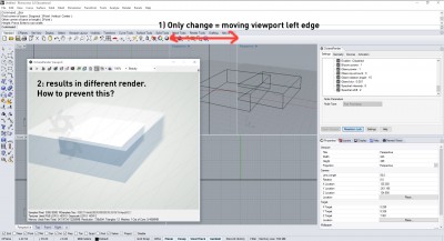

Hi Paul,
I tested the v3 Demo. The problem is still the same,
attached a file so hopefully you can see the issue.
If you resize the render viewport, the render changes. This makes the it very unpredictable and scary to change anything in the layout, which you do all the time when working with Rhino.
See attached images showing the difference and the attache rhino file. (in the next post. Somehow I keep getting a recaptcha when i want to upload.)
Thanks a lot for having a look at it.
viewport aspect ratio >< rendered aspect ratio

You can reproduce the problem by starting a render, and then while rendering resizing the viewport that is rendered.

Unless I am m misunderstanding your problem - this is the intended functionality, and the "roaming Rhino camera" is a Rhino issue rather than an Octane plugin problem (http://v5.rhino3d.com/forum/topics/view-lock and https://discourse.mcneel.com/t/how-can- ... ext/4813/6). The plugin sync's the Octane camera to the Rhino camera position of whichever viewport you have selected in Rhino. The Rhino camera position is panning when you change the Rhino viewport width. As Dottedline indicates, you should do the Octane render from a new viewport which always has the same aspect ratio - which will get around this issue....You can reproduce the problem by starting a render, and then while rendering resizing the viewport that is rendered.
1) Create New Viewport
2) Set View->Perspective
3) Save the new view as a named view. If you click Lock View, each time you select this view it will revert to the same camera position (http://docs.mcneel.com/rhino/5/help/en- ... edview.htm)
4) Open the Viewport - which will use the new named view if selected
5) Enter the second two commands listed by DottedLine above if you want the named viewport fixed to a certain size
6) You can click the Lock View button on the Octane Viewport to stop the camera changing to other Rhino viewports when you click on them
Paul
After posting the above, I realised there is a much easier way to do this....
Create a new Rhino perspective viewport
Open the Octane Viewport
Click the Camera Viewport Navigation button on the Octane Viewport - the Octane camera coordinates are now locked in, so you can move the Rhino viewport as required
If you have multiple camera positions you want to render from, rightclick the Settings tree and Save Rendertarget To View to lock the camera to that specific view and create other views
Hope that helps
Paul

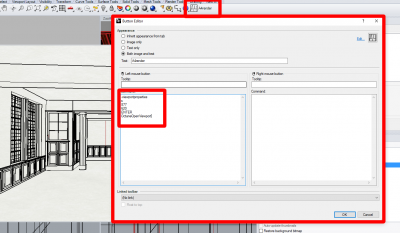

what v-cube said before improves for now the workflow. See also attached image where I made a button for A4 aspect ratio renders..v-cube wrote: -viewportproperties
s
1200
600
ENTER
OctaneRenderOpenViewport
When you click the button it will change to the correct aspect ratio and start rendering with the octane resolution. Make sure that octane also is set to the same aspect ratio.
