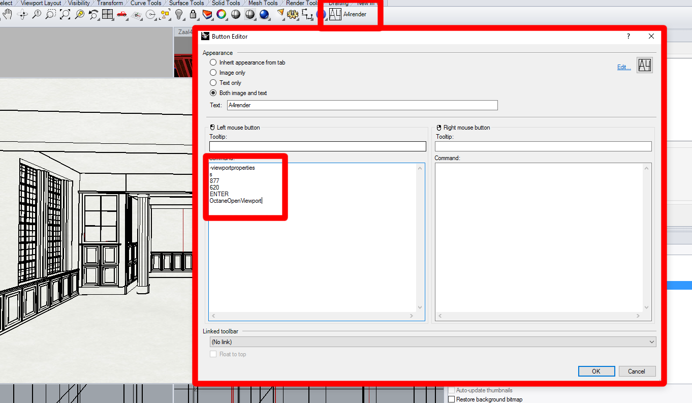

v-cube wrote: -viewportproperties
s
1200
600
ENTER
OctaneRenderOpenViewport
what v-cube said before improves for now the workflow. See also attached image where I made a button for A4 aspect ratio renders..
When you click the button it will change to the correct aspect ratio and start rendering with the octane resolution. Make sure that octane also is set to the same aspect ratio.
