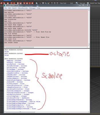

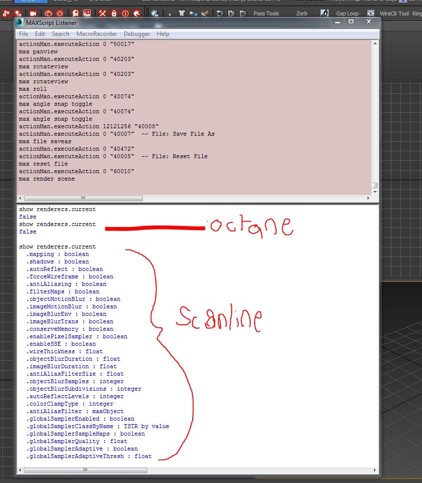

JimStar wrote:Guys, just wait.
I'm working on a huge plugin refactoring to make the MaxScript language fully supported and add other important features that require this refactoring.
So I just have no time to sit on the forums currently...
Hi JimStar,
I have no attention to interrupt your work.
But when you feel you're kind of close to integration.
Please make sure all or most of the Render Setup values can be accessed via maxscript.
to test that.
All you should do is
Open maxscript listener. In the white area you should write the below line (octane must be set as the current renderer.)
Code: Select all
show renderers.current
Below you can find the current results tested with Octane and Scanline Renderer.
Best,

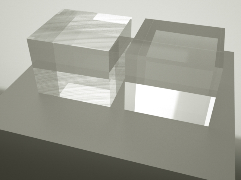

It is convenient to work with the tool Snaps toggle -- but if exposed glass and the subject have to edit and do an air layer in millimeters. You can avoid extra work ? Thanks

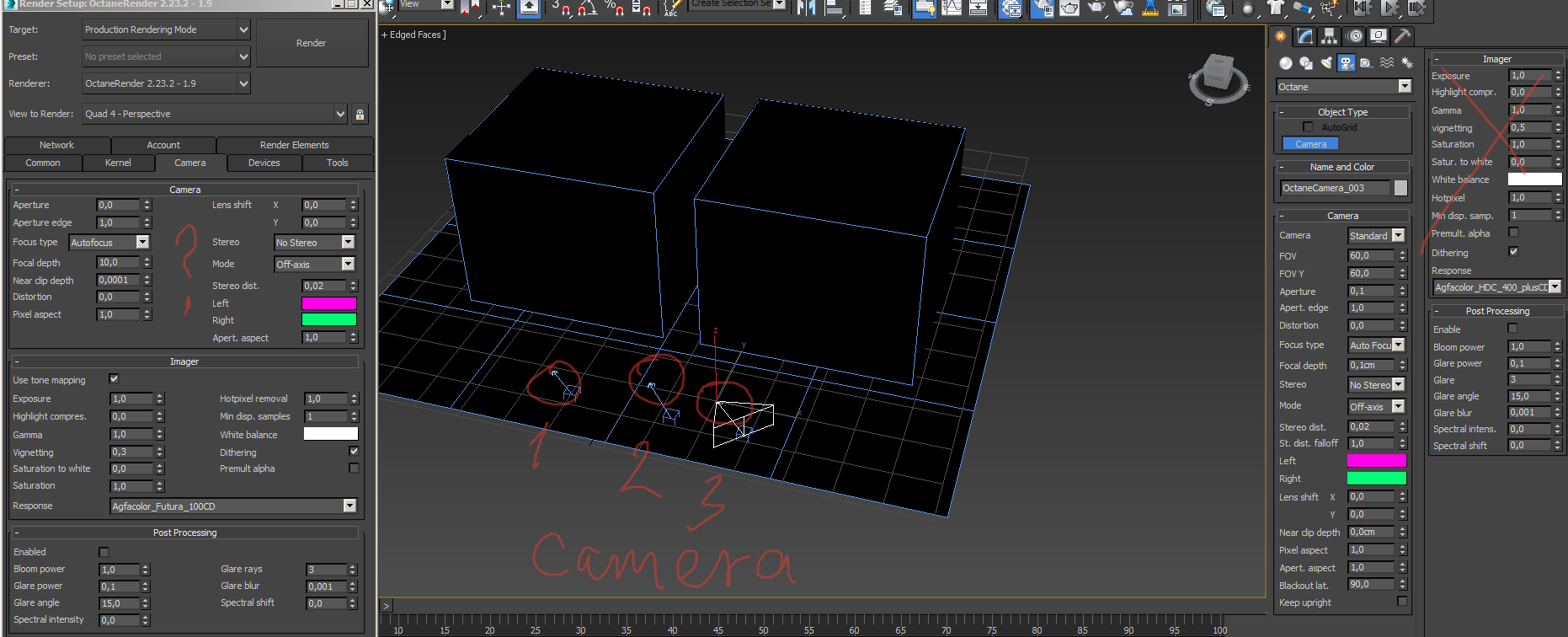

I can't find the control button of all cameras via General settings previously, this button was in previous versions

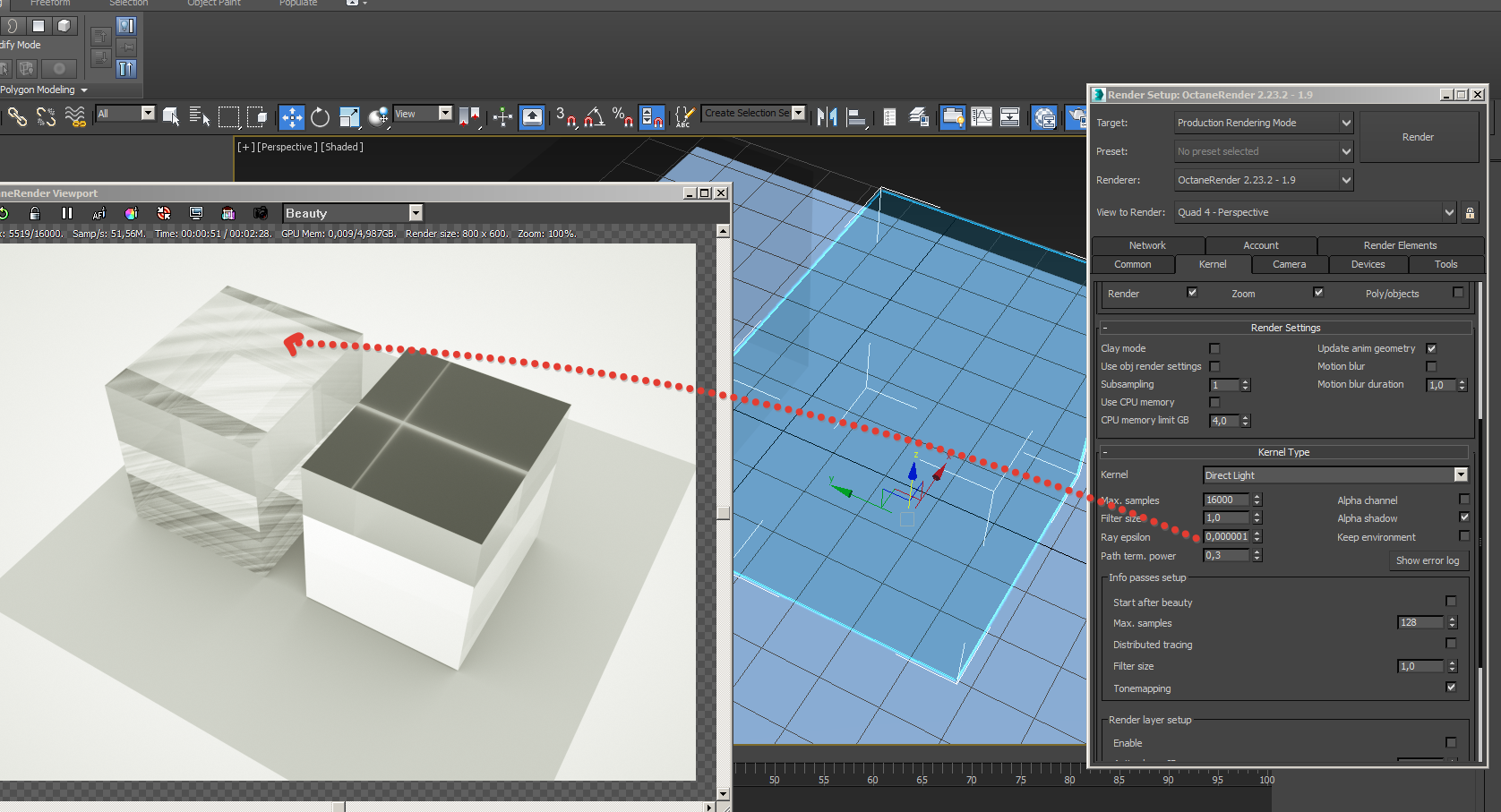

Goldisart wrote:It is convenient to work with the tool Snaps toggle -- but if exposed glass and the subject have to edit and do an air layer in millimeters. You can avoid extra work ? Thanks
I have no such problems, even if polygons are coplanar. problem in your scene. try make smaller value ray epsilon.

Also try to extend the precision parameter in max settings. that way you can lower the epsilon setting. like 0.0000001

+1 help :)
box.zip
(31.48 KiB) Downloaded 310 times
