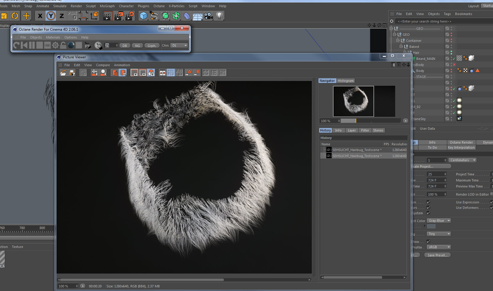

We have an issue with the hair rendering. Check the screenshots, scene is attached. Basically, the Octane Render will render faulty guides.
Here's the C4D standard renderer
Here's the same with Octane, the error very obvious
We tried the usual debugging approach of stripping the scene down to the minimal, which is attached. Error still shows up.

Hey mate,
where come from this output? LV or PV? Have you readed hair notes on manual?

@aoktar
It's picture viewer (final render), the hairs are generated at rendertime.
Of course we read the manual. Could you please look at the scenefile?

mate wrote:@aoktar
Thanks.
yes, checked. nothing looks strange. this is my output

Hey Aoktar,
It's a bit hard to reproduce, but here's another scene with the bug. It appears on three different computers here if I just open the scene and press render.

mate
Posts: 136
Joined: Fri Mar 19, 2010 2:51 pm
Location: Berlin
Also, please retry the first test scene a couple of times. The error still appears most of the times, just sometimes it doesn't. So I guess your quick test was just luck ;)
