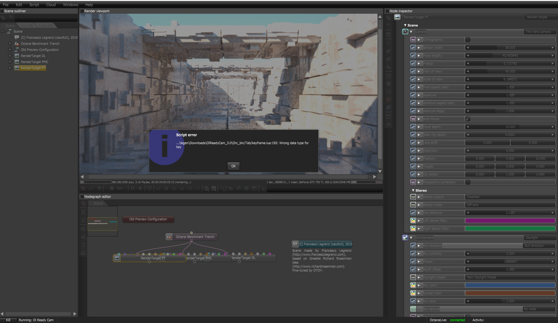

When i used "OI Ready Cam", it showed that
Wrong data type for key
Could anyone help me?
Thanks!
Posts: 10586
Hi Cosoli,
you are right, it works till v3 beta 1 and then it has stopped to work with that error message. Could you use v3 beta 1 while roeland find the time to have a look at the script to fix it?
ciao beppe
roeland
Posts: 1826
Yes the problem is the line keyframe.screenItem[b][[/b]i].slider.value = keyframe.item[b][[/b]ix]. I added more validation in the Lua API in a couple of places, to avoid such code failing silently if there's something wrong. The upshot is, if a value is set which is not the right type, or if you try to set nil then it will raise an error.

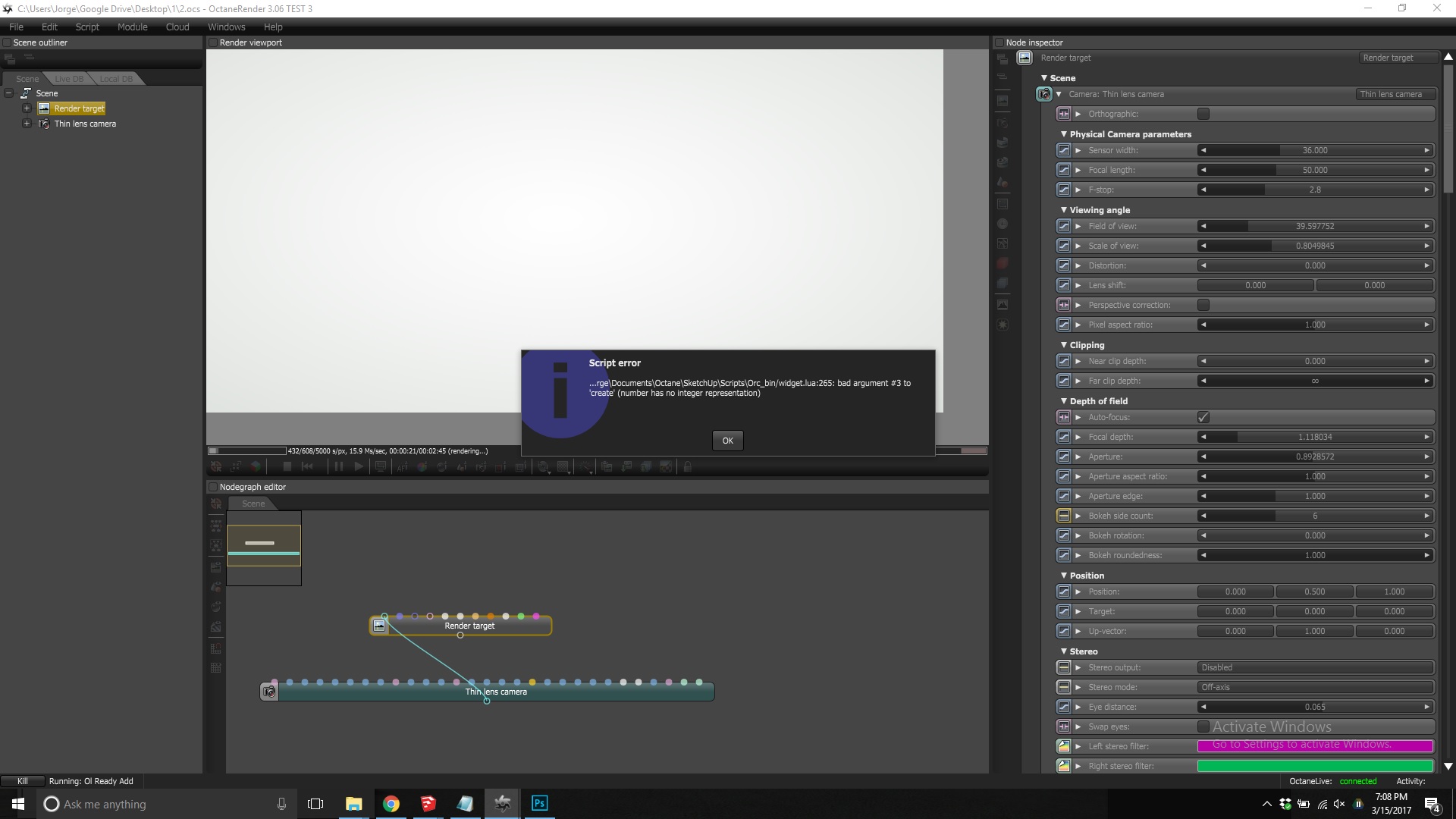

Hello Roeland and Bepeg!! , I have been using 3.06 TEST 3 for commercial work now, and it has been great. The Adaptive sampling works awesome.
But looks like it this LUA script got broken. If you could fix it yet again, would be greatly appreciated!.
I attach screen with error.
Thanks!

This is the part the error is complaining about
\orcbin\widget.lua
line 265 (self.bar = octane.gui.create), argument #3
Code: Select all
 progressBar = function(self, argv)
            type   = octane.gui.componentType.PROGRESS_BAR,
            text   = argv.text or "",
            width  = argv.width or 400,
            height = argv.height or 25,
            x      = argv.x or 0,
            y      = argv.y or 0
        return self
    end,
