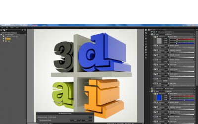

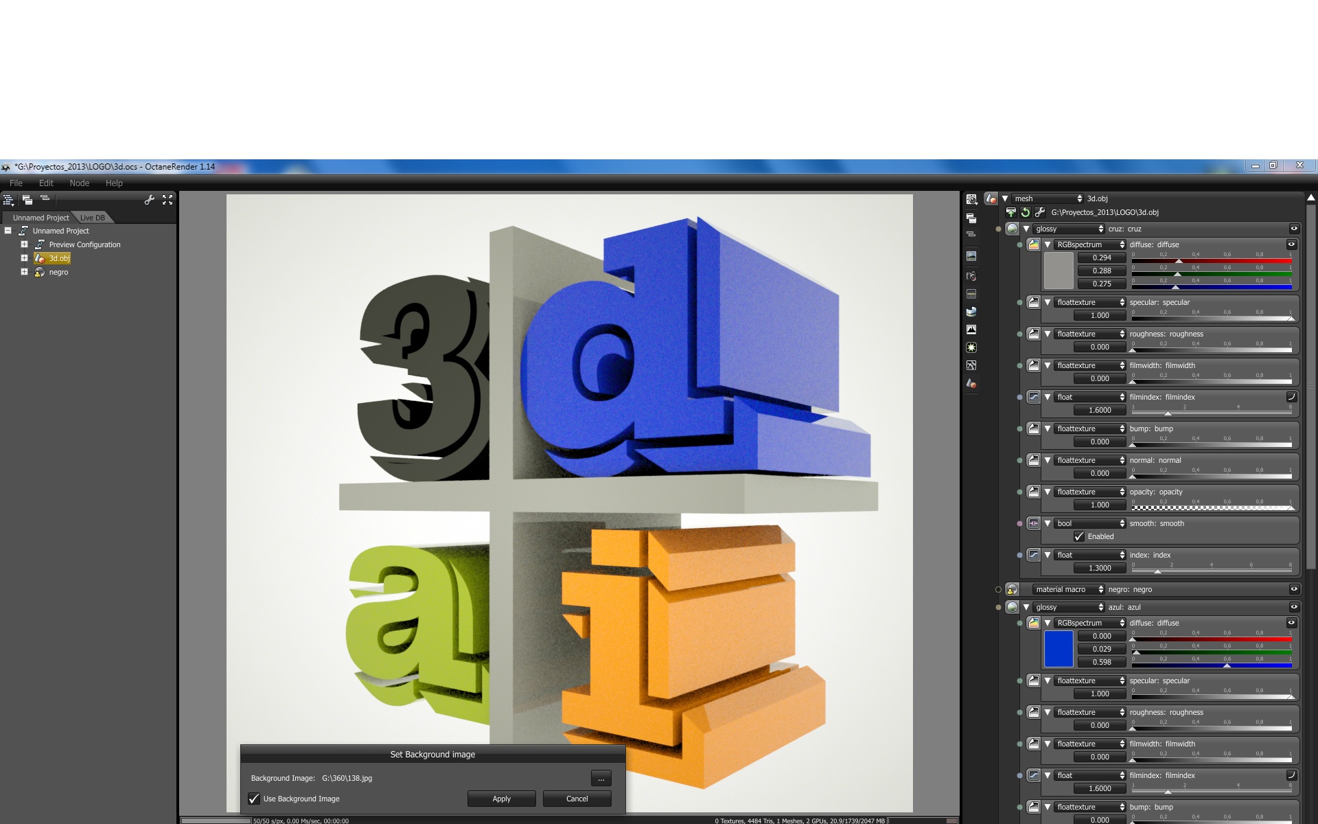

hi roeland, i can't upload the bakcground image, i mean i none versión i can't do it, can you help me please ?
add image
regards

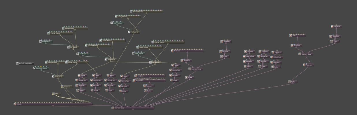

Here's a feature request for you. Can you do something about this mess? Being able to group complete objects would be nice. I use scatter nodes quite a lot and this always seems to end up in a complete mess of nodes with all the materials etc. If I could group all the details of a single object into a node so that I could just pin these nodes together then the view would be a lot less scary.

@steveps3 : this is a very tidy setup ! I have had some scenes spread onto the surfaces over 9 HD screens !
While waiting for the grouping feature, I have found that it is possible to group by hand by descending along all the branches of the tree.
- Select a node in the node graph.
- Put the mouse cursor over it in the node inspector.
- Copy it by right click.
- Disconect the link to the following node in the node graph.
- Select the following node in the node graph.
- Paste the previously copied node on the free pin showing "none", in the node inspector.
Repeat that for all branches and level of the tree.
I do that for every important part of a scene or complexe objects, and save the final node into a macro for reuse purpose.
I am currently making a collection of my best vehicles and buildings using this method. Each is contained in a unique node.
Tedious, but doable !

Merid, you need to enable alpha channel.. select render target, then kernel..
click enable in alpha channel settings.
But are you not using render targets in node graph?.. you appear to just have an
OBJ and nothing else.. maybe you just did that for a quick example.. but if you
are not adding render target nodes (etc) to the node graph area and plugging in
your OBJs to those (geometry groups, actually, then those into render targets),
you are doing things the hard way...

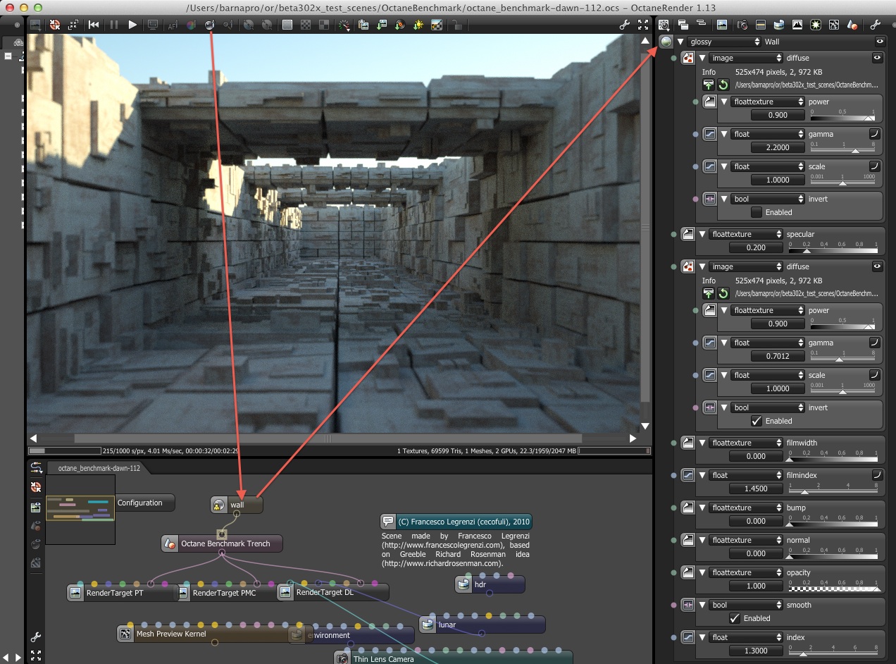

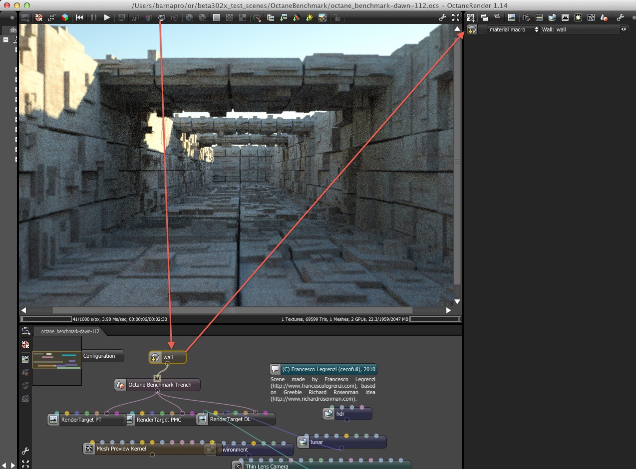

Posts: 10510
little bug, if i use the material picker, now the material is not displayed entirely in the node inspector but only the macro node:
ciao beppe

thank you FrankPooleFloating but i don't know where is the alpha cannel, can you help me ? thank you

merid888 wrote:thank you FrankPooleFloating but i don't know where is the alpha cannel, can you help me ? thank you
Page 55 in the manual.

thank you zay, maybe a Little video tutorial ?
