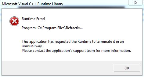

I am having a problem with strands. First, no matter what i do the second frame (on which strands are generated) won't render in animation mode. This isn't a big problem, but i feel is somehow connected to the second one. I setup my scene, render frame, render animation. Everything is fine. Then i add some camera movement or change anything else (like smooth a geometry object strands are connected to) and BAM! No more rendering. Animation won't render, a single frame won't render. Even if i delete OctaneExporter node and export to a new project Octane crashes and gives me an error (see attachment). Merging the scene with a new one doesn't help either. Basically the XSI scene becomes useless. What am i doing wrong?
EDIT: Somehow the internal Softimage Obj exporter gets jammed, restarting XSI seems to help. Everytime i cancel rendering to change something the error occurs.

jamnique wrote:I am having a problem with strands. First, no matter what i do the second frame (on which strands are generated) won't render in animation mode. This isn't a big problem, but i feel is somehow connected to the second one. I setup my scene, render frame, render animation. Everything is fine. Then i add some camera movement or change anything else (like smooth a geometry object strands are connected to) and BAM! No more rendering. Animation won't render, a single frame won't render. Even if i delete OctaneExporter node and export to a new project Octane crashes and gives me an error (see attachment). Merging the scene with a new one doesn't help either. Basically the XSI scene becomes useless. What am i doing wrong?
Thats correct, there is a bug if you cancel the export. Restart XSI should help...
