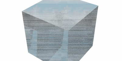

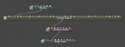

bepeg4d wrote: Hi,
can you share a screenshot of the entire interface?
ciao Beppe
I have looked into this some more, and maybe there is an issue with the Universal material.
In case it helps. Here is the interface and the viewport result.
A new scene, with no other changes. It does not seem to matter which texture map I use - this one was a 4k export out of Substance Painter.
plasmapeppers
Posts: 21
Joined: Mon Jul 29, 2019 10:31 pm
I can verify something is up with universal and metallic maps, I set Metalness to 1.0 float and it just ... stopped rendering. It won't start back up, won't restart. The app isn't frozen, I can still adjust the nodes, change settings etc. Even deleting the offending Universal material does nothing. The other tex inputs work fine it seems. I also tried a Noise node, same odd freeze behavior. This is with my Intel Integrated graphics enabled or by itself. Disabling the Intel GPU returns functionality to normal. Universal + Metallic work with just the Radeon VII. I suspect this is why the issue manifests on M1, which is also technically an integrated GPU.

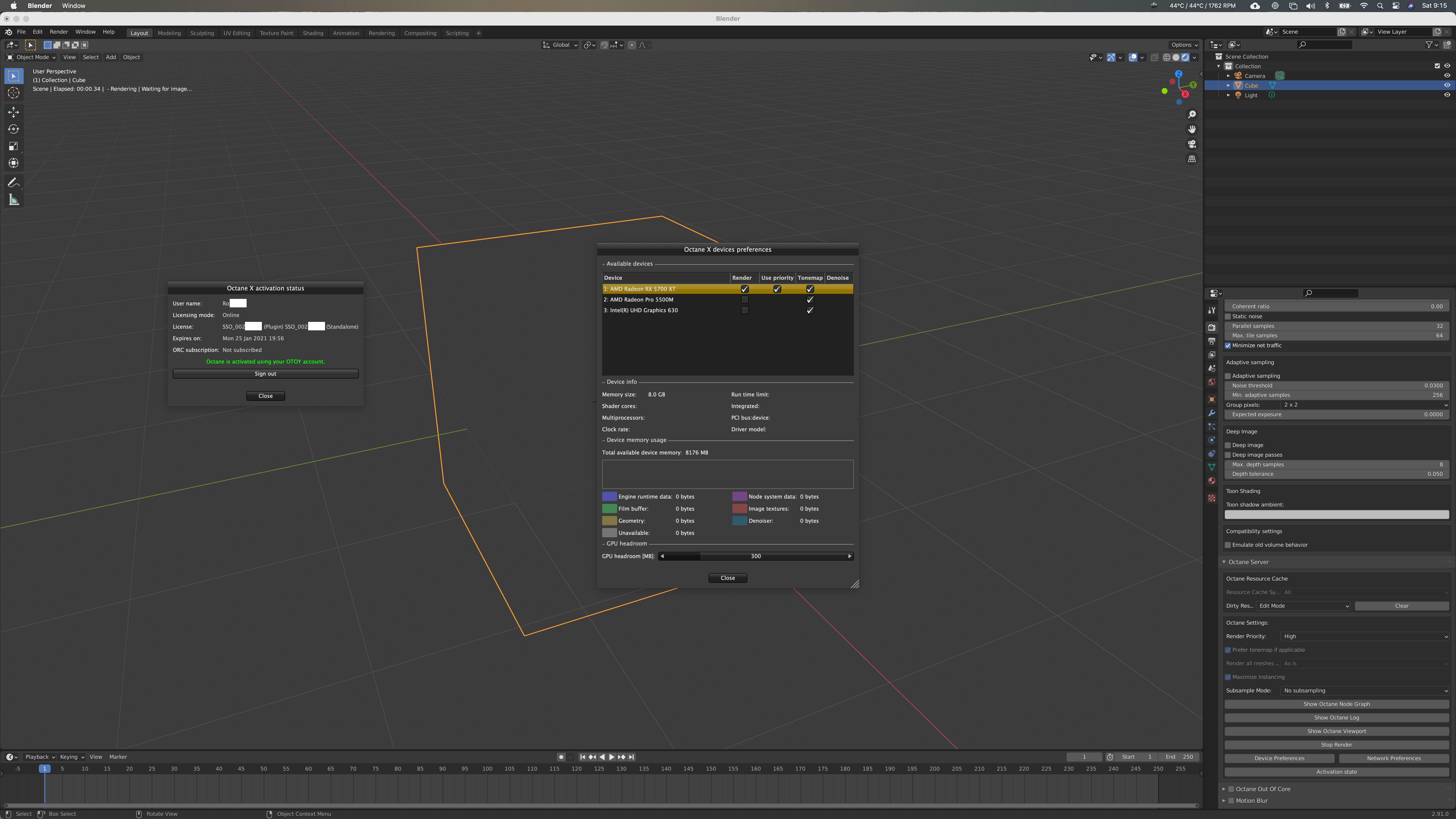

Can anyone help me understand what I am doing wrong here? I have not been able to get OctaneRender and now OctaneX to ever get past a "waiting for image" hang on Blender.
I had the same problem on my PC with CUDA, and had been waiting for OctaneX to try it on my MacbookPro.
16" i9 Macbook pro with 5500M and a 5700XT in eGPU.
Image never renders, but the GPU can sit there for hours at 100% utilisation (this is on the default cube scene).
This is all just a clean install and then render.
Weezer
Posts: 376
Joined: Tue Dec 04, 2012 10:08 am
Apparently this is being fixed for the next build. For me, this will be the last major issue. OctaneX has been great so far!
