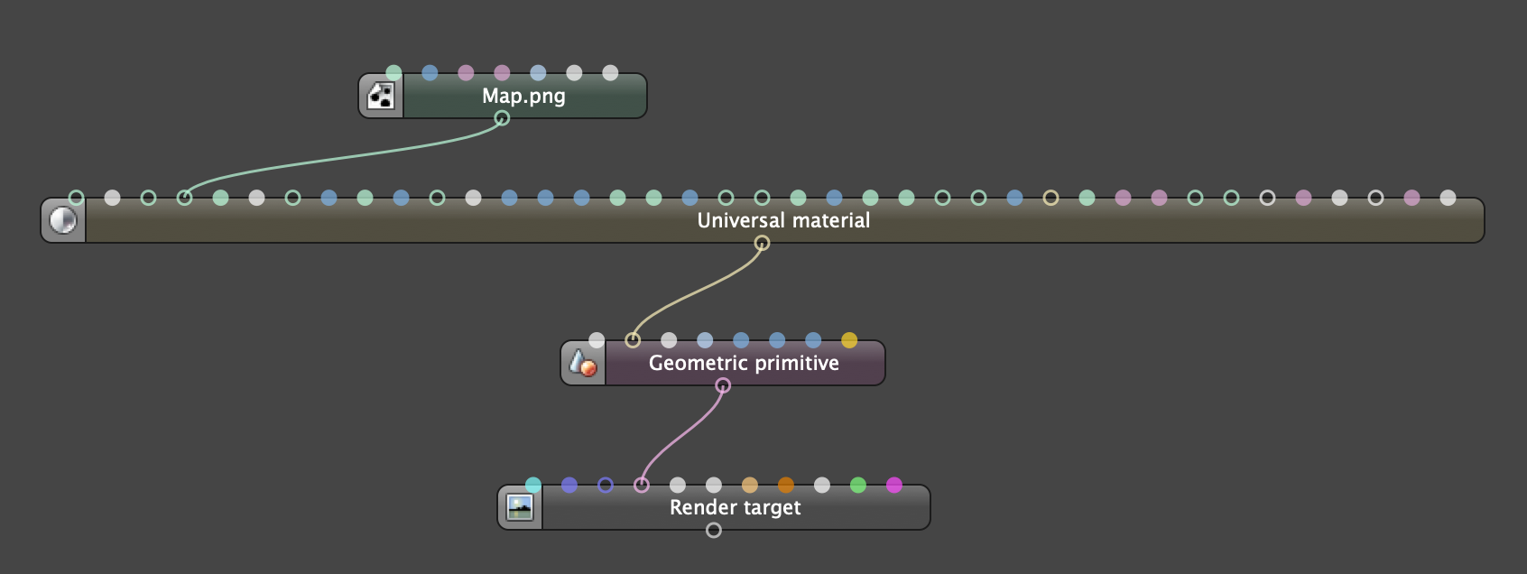

I have looked into this some more, and maybe there is an issue with the Universal material.bepeg4d wrote: Hi,
can you share a screenshot of the entire interface?
ciao Beppe

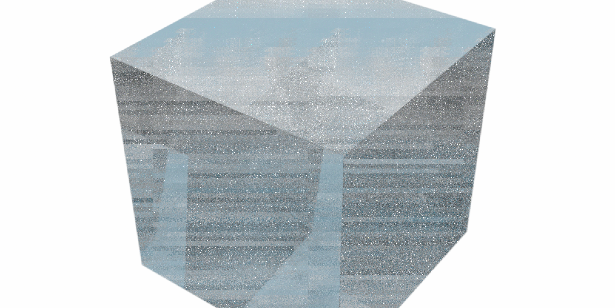

In case it helps. Here is the interface and the viewport result.
A new scene, with no other changes. It does not seem to matter which texture map I use - this one was a 4k export out of Substance Painter.

I can verify something is up with universal and metallic maps, I set Metalness to 1.0 float and it just ... stopped rendering. It won't start back up, won't restart. The app isn't frozen, I can still adjust the nodes, change settings etc. Even deleting the offending Universal material does nothing. The other tex inputs work fine it seems. I also tried a Noise node, same odd freeze behavior. This is with my Intel Integrated graphics enabled or by itself. Disabling the Intel GPU returns functionality to normal. Universal + Metallic work with just the Radeon VII. I suspect this is why the issue manifests on M1, which is also technically an integrated GPU.
