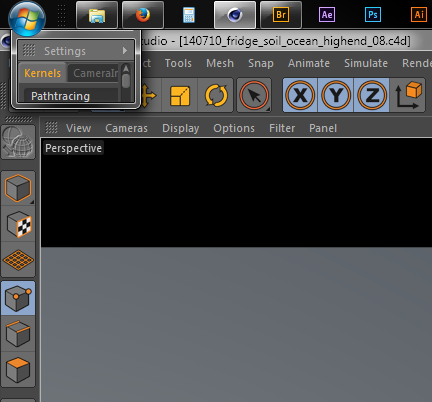

hey aoktar. since working in c4d with a second monitor and a two-screen user-startup-layout, everytime i open the octane-settings they pop up in a tiny window that i have to resize everytime i use it. see the screenshot. is this problem known? or is it a setup mistake i did with my screens and c4d-layout?
br.
mo
Posts: 16068
Location: Türkiye
momade wrote:hey aoktar. since working in c4d with a second monitor and a two-screen user-startup-layout, everytime i open the octane-settings they pop up in a tiny window that i have to resize everytime i use it. see the screenshot. is this problem known? or is it a setup mistake i did with my screens and c4d-layout?
br.
mo
i have two monitor. Hard to say exact words. It's still a mistery for me. Something is not easy in c4d like setting the sizes of dialogs.
